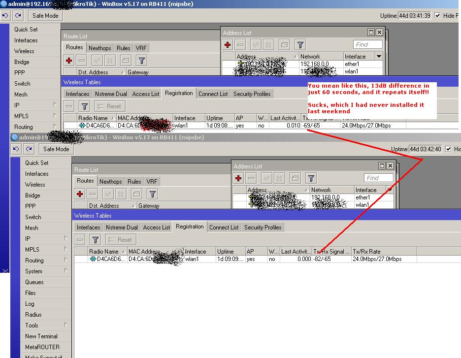

You mean you are seeing something like this.. (see attached) In the space of 1 minute the signal as seen from the client end fluctuates up and down by 13dB.
Before I installed it at the weekend ( now unable to even mac-tel or ssh into it) everything was fine with a RB433ah + XR2
Yes, similar. And the clients are disconnecting in groups simultaneously. Mikrtotik clients stay connected the longest.
