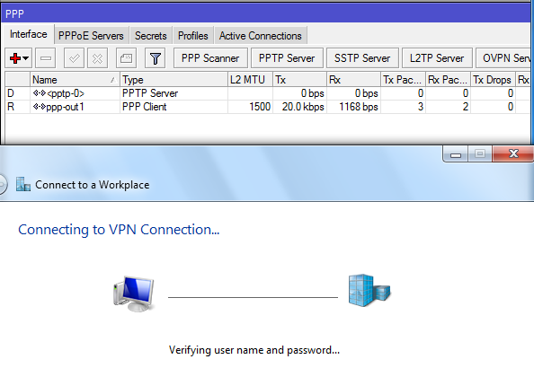

This is the export file
and I can see PPTP connection for 5-7 sec ,and then it’s gone

One step at a time…
What is the home client trying to make the PPTP connection? Settings? Error messages?
“A connection to the remote computer could not be established, so the port used for this connection was closed.”
and the setting of the VPN connection are default- didn’t change nothing
