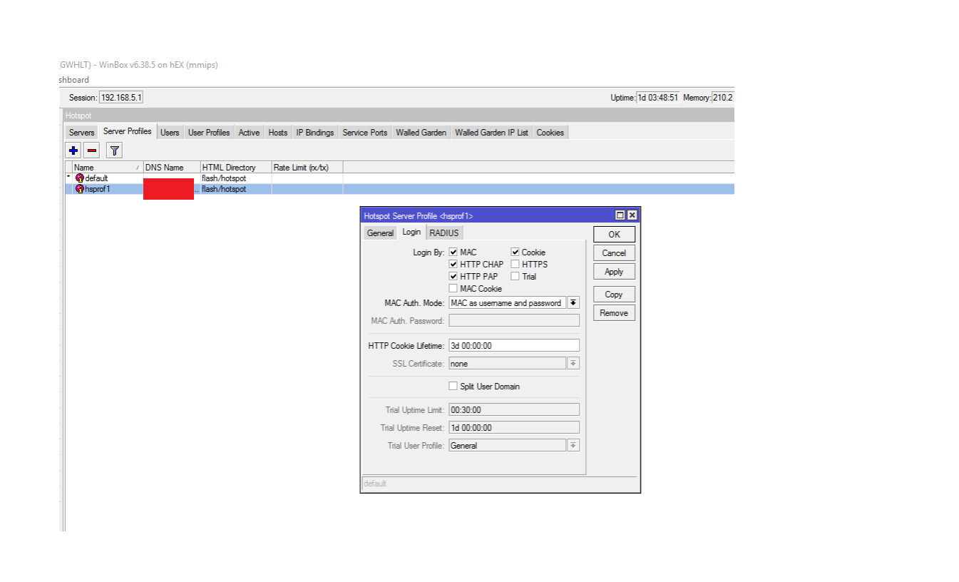

Hello, I’m using a RB 750 GR3, everything it’s ok, but I’m having a problem with the hotspot.

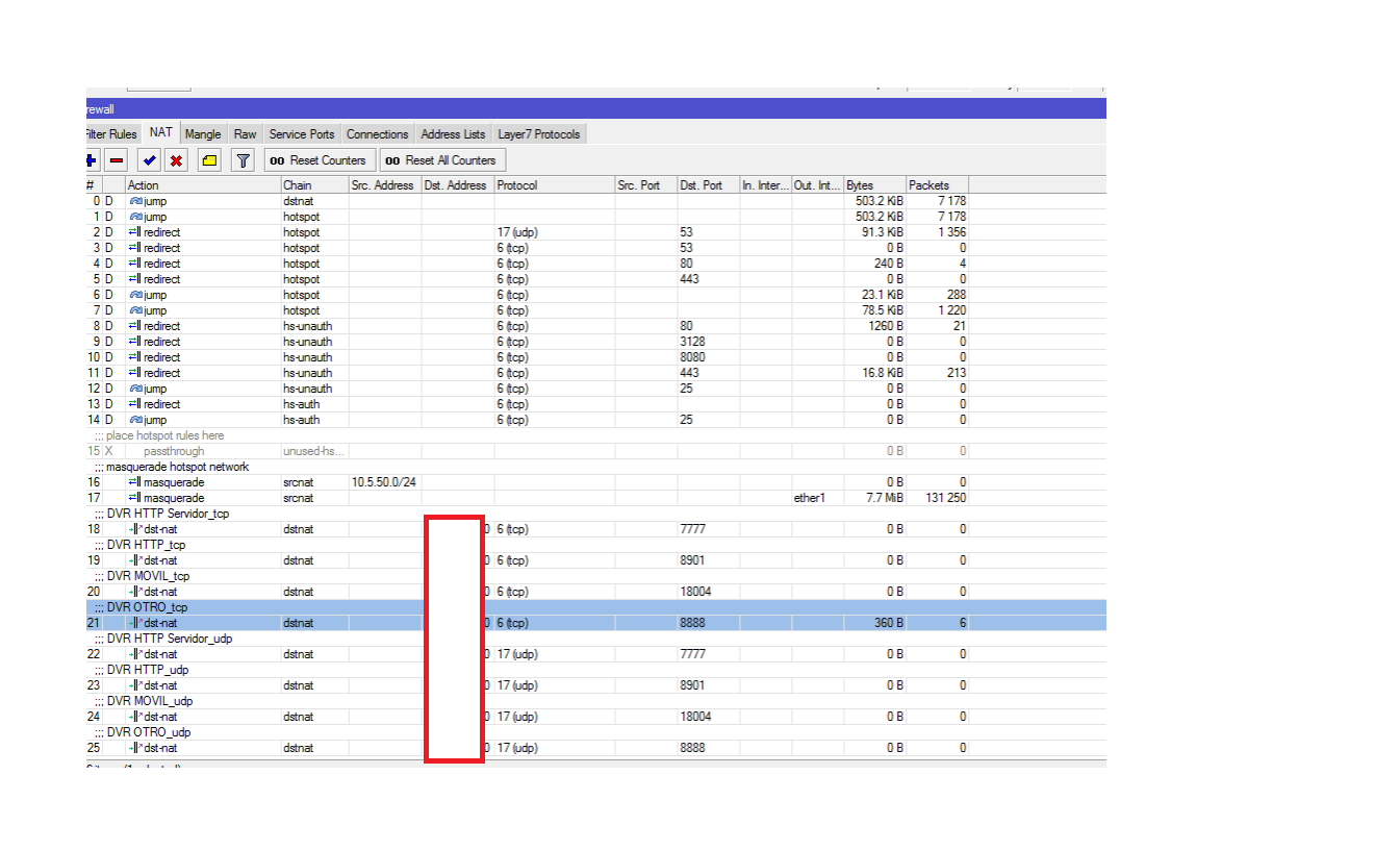

I have a network with 3 Airlive in AP mode, a DVR for the cam, and a Server in my Hotel ( everything wired to a swtich and then wird to the ethernet2 in the mikrotik ). I don’t know why even If I have the Hotspot login with Mac Auth. Mode: Mac as username and password as you can see in the image I can’t get access to the Airlive Control Panel or DVR with the cams. I add it all the MAC as user and password. But if the Hotspot it’s enable I can’t get Access to the Server or the Airlive. But If the Hotspot it’s disable I can get successful access to all the devices without any problem.
Can anyone help me?, I don’t know what’s going on, I attach the Firewall NAT imagen and Hotspot Server Profile, I don’t know what to do.

I suggest you try the “IP Bindings” menu.
There you can bypass some IP from the hotspot to avoid blocking communication.
Hi, thank you!, Yes worked fine!.
And also the Hostpot server must be selected address pool: none and all the devices work’s fine.
