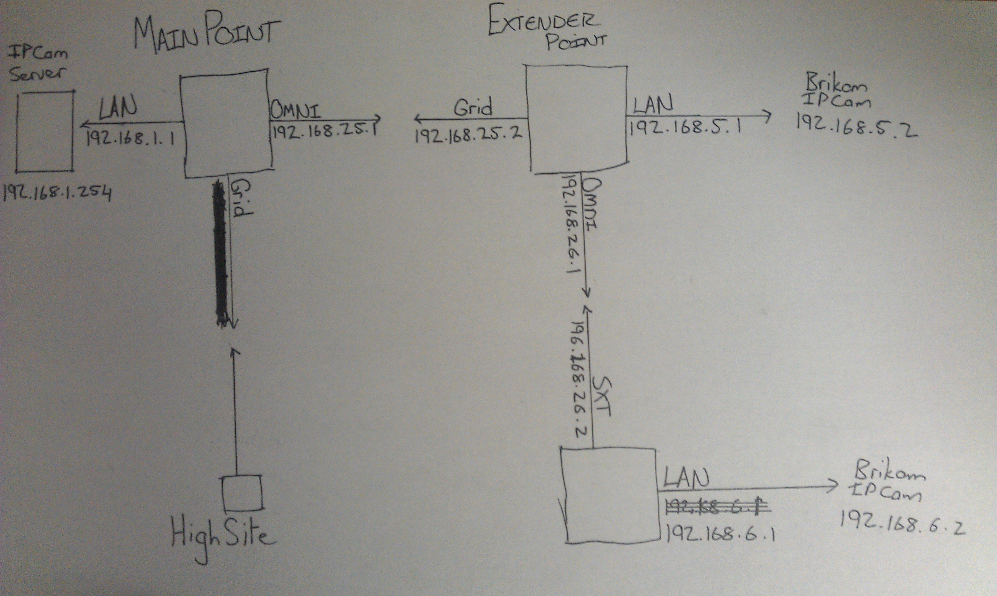

Let me begin with the layout.
Main Point (A) - Omni and Grid.
Grid - Points to High site for internet access
Omni - Connection for first Extender Point
Extender Point (B) - Omni and Grid
Grid - Connects to omni at Main Point
Omni - Access for Nodes
Node Point (C) - SXT
SXT - Connects to Omni sy Extender Point
Below I've added a drawn layout to make it a bit easier.
In the attached pic you will see the IP's and where what goes.

I will post routes that I've added below:
Routes
MAIN POINT
DST-ADDRESS PREF-SRC GATEWAY DISTANCE
0 A S 0.0.0.0/0 192.168.210.1 1
1 ADC 192.168.1.0/24 192.168.1.1 LAN1 0
2 A S 192.168.5.0/24 192.168.25.2 1
3 A S 192.168.6.0/24 192.168.25.2 1
4 ADC 192.168.25.0/24 192.168.25.1 HBC-MAIN 0
5 A S 192.168.26.0/24 192.168.25.2 1EXTENDER
0 A S 0.0.0.0/0 192.168.25.1 1
1 ADC 192.168.5.0/24 192.168.5.1 LAN1 0
2 A S 192.168.6.0/24 192.168.26.2 1
3 ADC 192.168.25.0/24 192.168.25.2 EXT-GRID-1 0
4 ADC 192.168.26.0/24 192.168.26.1 EXT-OMNI-1 0SXT
0 A S 0.0.0.0/0 192.168.26.1 1
1 ADC 192.168.6.0/24 192.168.6.1 LAN1 0
2 ADC 192.168.26.0/24 192.168.26.2 SXT-ONE 0
