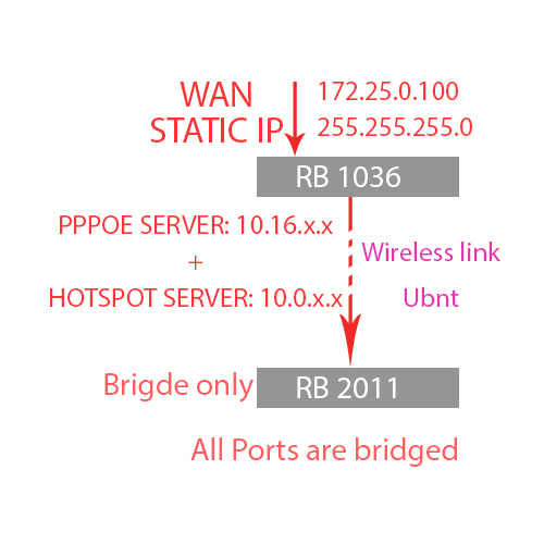

As I’ve started writing the answer I’ve realized I don’t understand exactly your topology. Does the Mikrotik in question act as a PPPoE server to which other PPPoE clients connect, or as a PPPoE client on the internet uplink? If it is a PPPoE server for other clients, using what kind of interface it is connected to Internet, plain Ethernet or PPPoE (or something else)?
Thanks for your reply.
It is connected to internet using static ip.
It is acting as PPPOE server and Hotspot server.
Here is a picture:
And where is/are your PPPoE client? In the 2011 or in users equipment connected to the 2011?
Thank you pe1chl,
2011 is working as bridge, and the clients are connected after it.
After 2011 there are wireless access points —> stations —> clients
Some of the clients are TP-Link routers others are Ubnt Nanosation devices. And the end-users are connected to those routers using their mobile phones and computers.
