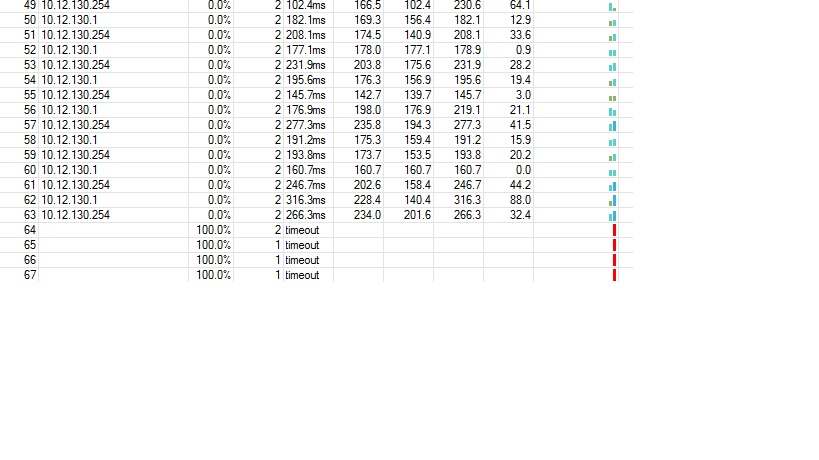

I have a customer who cannot access gamepedia dot com. The ip of the server its hosted on is 141.101.114.101
When I log into my BGP router which the customers traffic is going out through I get this ping pong effect.

When I do a traceroute on the 2nd BGP router to the affected networks, the trace is fine, but when I do the same traces on the 1st BGP router, they just ping pong from the affected BGP router to the next internal router on the way into the network and back again.
