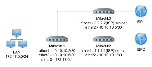

I have some problem with my mikrotik network.
The LAN is connected to Mikrotik1. Mikrotik1 have two routes to the global network: Mikrotik2 and Mikrotik3.
When i want to open sites from lan, i have a problem, some sites(like google or yandex) works, but many others(like 2ip and ping.eu) do not work, connection is established by page not loading. Traceroute and ping is workeng for all resources, i try to disable all firewall rules, but it not fix problem.

Mikrotik1 have 1 more connection with another ISP, it’s a main channel. Another two(over mikrotik2 and Mikrotik3) it’s reserve.

I try to reproduce scheme with another mkt(without real isp) and it works fine. I think problem with my pbr rules, try to reconfigure it.

On the mkt1 i had br interface with eth2(172.17.0.1/24) and two eoip connection. Now i remove this bridge and reconfigure ip to eth2…and it works fine without changing mtu and mss…
