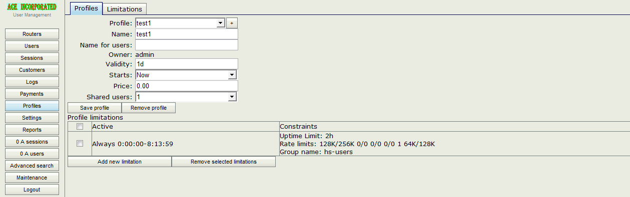

I have the following problem. When radius server (UM) disconnects the user the profile assigned to the user is also removed from the user but not from the profiles.

your validity=1d
your uptime=2h
your limitation time=0:00:00-8:13:59
the time 0:00:00-8:13:59 in just 1 day, in other day username test1 can’t login
if username test1 login at 1:00:00, user test1 session timeout at 3:00:00.
try to your validity=1w
your limitation uptime=5d
time same with config 0:00:00-8:13:59

Is that so, I have users,
Validity=30d
Uptime=Unlimited
time config=00:00:00-7:59:59
I have 7 users for that config, I am getting the same problem. The snapshot is just for testing purpose. I give this account for the users who want to test my internet connection before buying a package.
by the way your profile config
starts:now
have you try starts: at first logon?
