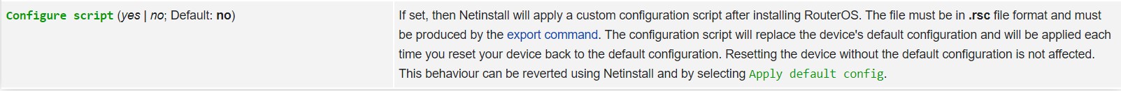

netinstall what happens then? Same question arise.
Well my intended workaround was …
Netinstall with custom script, that sets ‘my’ password, or adds an ‘admin enabled’ extra user ?
