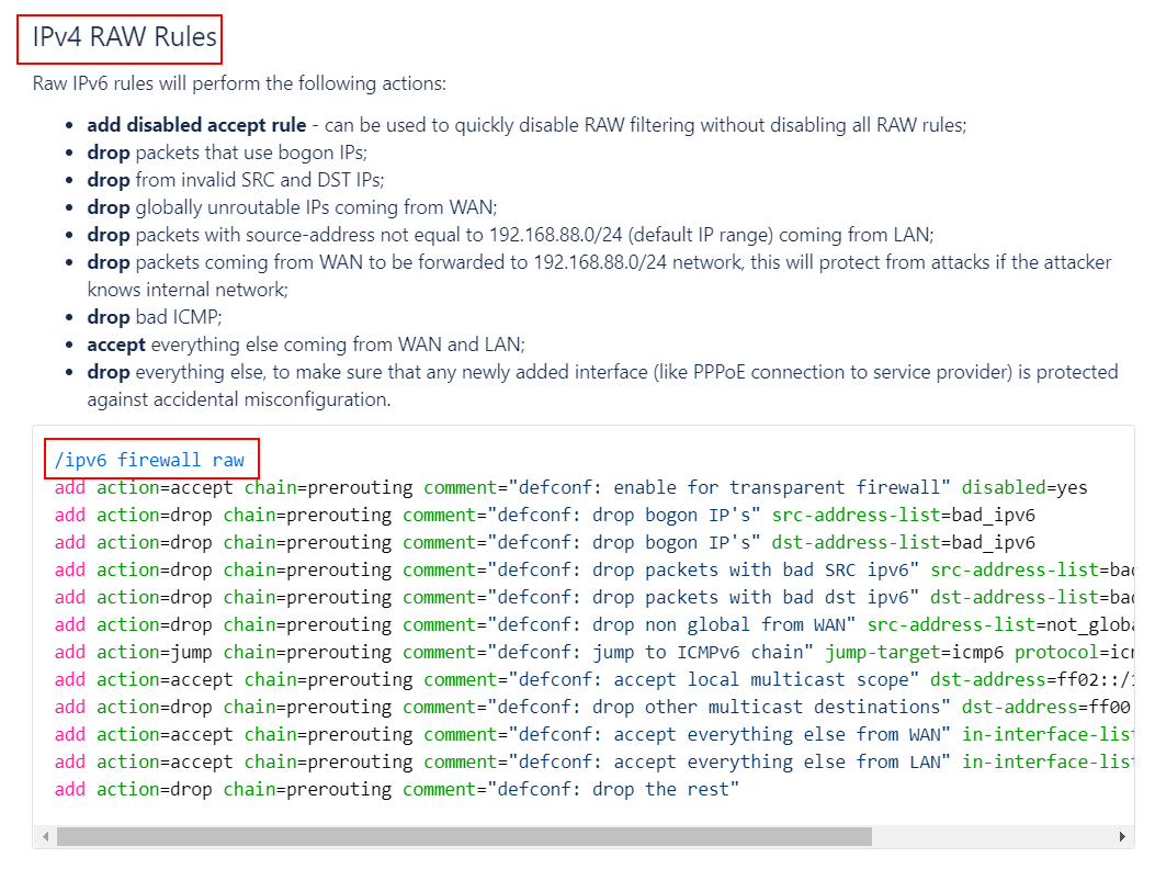

2.should be ipv6 raw rule
https://help.mikrotik.com/docs/display/ROS/Building+Advanced+Firewall#heading-IPv4RAWRules-2

192.168.0.0/16 was added by mistake.
Also fixed title form IPv4 to Ipv6.

And is this right?
/ipv6 firewall address-list
add address=2001::/32 comment="defconf: RFC6890 TEREDO" list=not_global_ipv6
/ipv6 firewall raw
add action=drop chain=prerouting comment="defconf: drop non global from WAN" src-address-list=not_global_ipv6 in-interface-list=WAN
Yes should be correct,
