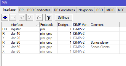

I have Sonos players in VLAN99, PIM is active and FW rules are also implemented. It works, but not very well. A new controller can only be added to the system, if i put it temporarily in VLN99 . Same with SW-Updates. I cannot start SW-Updates from the "Controller-VLAN10, only if the controller is in the player VLAN.
I have configured manually, not via script. Maybe I missed something, Can someone please confirm, that SW Updates work fine from Controller VLAN?

You added both vlan interfaces to PIM module? I would double check the firewall rules and make sure they are exactly like if the script did it. I did it manually without script too and I am pretty sure a software update worked in the past however I have not tried an update recently.
thanks for quick reply! Yes, VLAN30, VLAN10 and the other Controller VLAN is configured in PIM
I will check Rules tomorrow again, and will let you know! Maybe I do not see my issues! :slight_smile:
But please check in parallel, if you can add a new controller in the Controller VLAN, or if you can update the Sonos. 10.5 is online!
