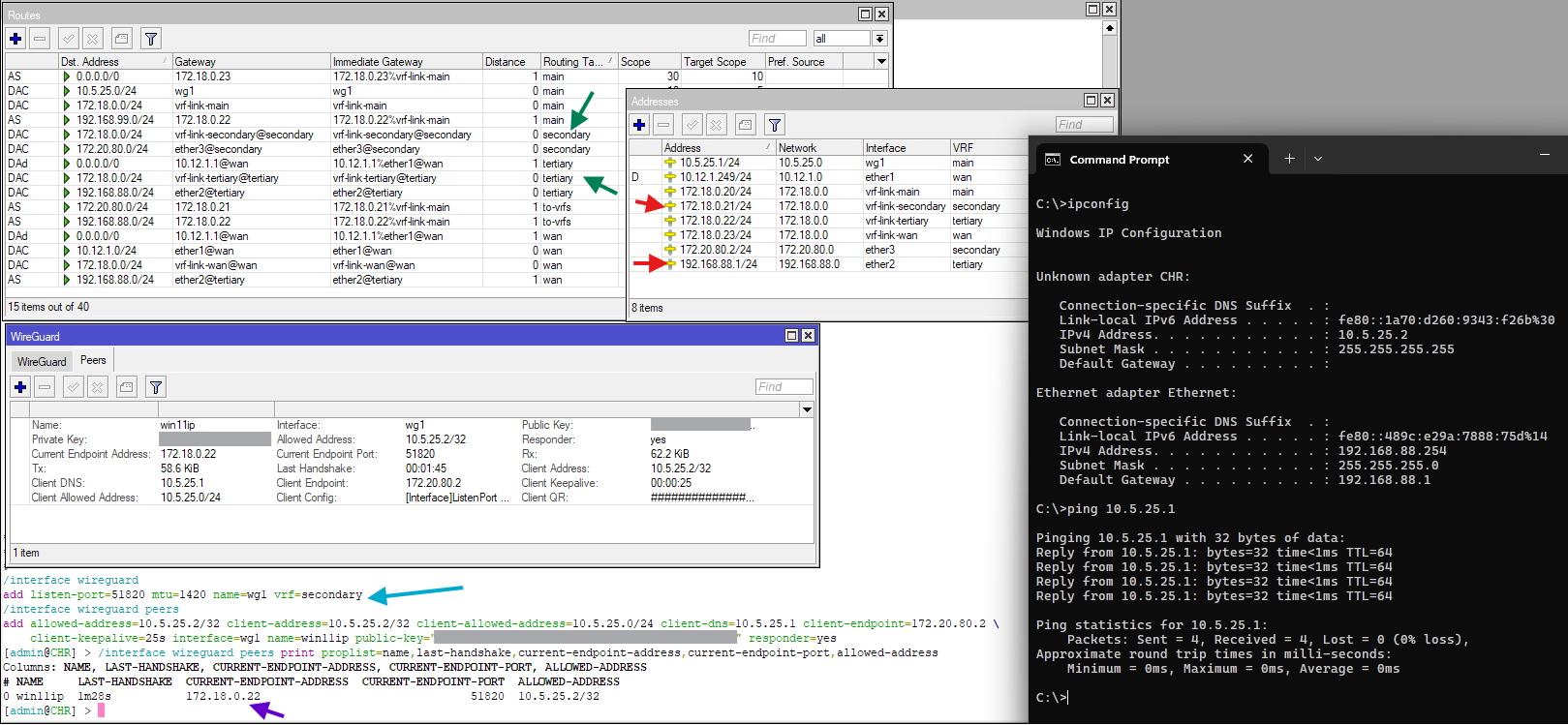

I just did a test configuration and nothing much to be done for it to work. In fact, starting from the test configuration of this post: Accessing router-hosted services (DNS, HTTP, etc) from a VRF - #9 by CGGXANNX a single additional SRCNAT rule was required. And I only linked to that post for the definition of the VRFs, the MACVLANs, and the addresses. The NAT or mangle rules from that post is not required (they are needed for accessing services in main only).
From the screenshot you can see that the Windows VM which has 192.168.88.254 as address is in the VRF tertiary. The WireGuard is set up to listen in the secondary interface. You can see that there aren't even any VRF route leaking between the two VRFs required. No routes from secondary to tertiary and vice versa.
WG client on Windows is working, and Windows is able to ping the address of the router inside WG (10.5.25.1).
