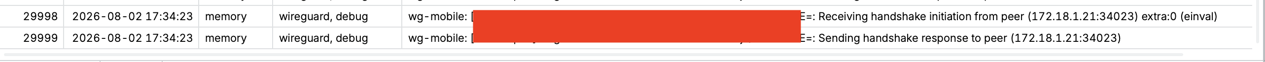

The logs show that wireguard responds:

/ip firewall address-list add address=192.0.2.210 list=localhost_as
/ip firewall address-list add address=192.0.2.222 list=localhost_as
/ip firewall filter add action=accept chain=input comment="defconf: accept ICMP after RAW" protocol=icmp
/ip firewall filter add action=accept chain=input comment="defconf: accept established,related,untracked" connection-state=established,related,untracked
/ip firewall filter add action=accept chain=input comment="SSH access from everywhere" dst-port=1983 protocol=tcp
/ip firewall filter add action=accept chain=input comment="Wireguard server" dst-port=51820 protocol=udp
/ip firewall filter add action=accept chain=input comment=Winbox dst-port=8291 protocol=tcp src-address-list=private_lans
/ip firewall filter add action=accept chain=input comment="DNS server for own hosts" dst-port=53 protocol=udp src-address-list=own_hosts
/ip firewall filter add action=accept chain=input dst-port=53 protocol=tcp src-address-list=own_hosts
/ip firewall filter add action=accept chain=input comment="API (checkmk)" dst-port=8728 in-interface-list=SRV protocol=tcp src-address=10.227.4.12
/ip firewall filter add action=accept chain=input comment="SNMP (checkmk)" dst-port=161,162 in-interface-list=SRV protocol=udp src-address=10.227.4.12
/ip firewall filter add action=reject chain=input comment="defconf: drop all not coming from trusted" in-interface-list=!trusted reject-with=icmp-port-unreachable
/ip firewall filter add action=drop chain=input comment="Log & block everything else" log=yes log-prefix="[BLOCKED-IN]"
/ip firewall filter add action=accept chain=forward comment="XVRF: Allow ssh access from vrf-as" dst-port=1983 out-interface=vrf-main protocol=tcp src-address=192.0.2.0/24
/ip firewall filter add action=accept chain=forward comment="XVRF: Allow dns access from vrf-as" dst-port=53 out-interface=vrf-main protocol=udp src-address=192.0.2.0/24
/ip firewall filter add action=accept chain=forward comment="XVRF: Allow wireguard access from vrf-main. TODO: restrict again" dst-port=51820 protocol=udp
/ip firewall filter add action=accept chain=forward comment="XVRF: Allow wireguard access from vrf-main. TODO: restrict again" protocol=udp src-port=51820
/ip firewall filter add action=accept chain=forward comment="XVRF Hack 1: Mikrotik" dst-address=159.148.147.0/24
/ip firewall filter add action=accept chain=forward comment="defconf: accept established,related, untracked" connection-state=established,related,untracked
/ip firewall filter add action=jump chain=forward comment=traffic_zones connection-state=new jump-target=traffic_zones
/ip firewall filter add action=drop chain=forward comment="defconf: drop invalid" connection-state=invalid log=yes log-prefix=INVALID
/ip firewall filter add action=drop chain=forward comment="defconf:  drop all from WAN not DSTNATed" connection-nat-state=!dstnat connection-state=new in-interface-list=WAN
/ip firewall filter add action=drop chain=forward comment="defconf: drop bad forward IPs" src-address-list=no_forward_ipv4
/ip firewall filter add action=drop chain=forward comment="defconf: drop bad forward IPs" dst-address-list=no_forward_ipv4
/ip firewall filter add action=accept chain=forward comment="Check if counters >0. If not, DROP here" log=yes log-prefix="[ACPT]"
/ip firewall filter add action=accept chain=traffic_zones comment=LAN->VPN in-interface-list=LAN out-interface-list=MOBILE
/ip firewall filter add action=accept chain=traffic_zones comment=LAN->SRV in-interface-list=LAN out-interface-list=SRV
/ip firewall filter add action=accept chain=traffic_zones comment="LAN->ADM (ToBeRestricted!!)" in-interface-list=LAN out-interface-list=ADM
/ip firewall filter add action=accept chain=traffic_zones comment=VPN->LAN in-interface-list=MOBILE out-interface-list=LAN
/ip firewall filter add action=accept chain=traffic_zones comment=VPN->SRV in-interface-list=MOBILE out-interface-list=SRV
/ip firewall filter add action=accept chain=traffic_zones comment="VPN->ADM (ToBeRestricted!!)" in-interface-list=MOBILE out-interface-list=ADM
/ip firewall mangle add action=mark-routing chain=output comment="XVRF PortFW: ssh" new-routing-mark=vrf-as out-interface=vrf-as protocol=tcp src-port=1983
/ip firewall mangle add action=mark-routing chain=output comment="XVRF PortFW: dns" new-routing-mark=vrf-as out-interface=vrf-as protocol=udp src-port=53
/ip firewall mangle add action=change-mss chain=forward comment="MSS/MTU fix for wg" new-mss=1380 out-interface-list=mss_fix protocol=tcp tcp-flags=syn tcp-mss=1381-65535
/ip firewall nat add action=dst-nat chain=dstnat comment="XVRF: Access ssh from vrf-as as 192.0.2.210" dst-address=192.0.2.222 dst-port=1983 in-interface-list=MY_PREFIX protocol=tcp src-address=192.0.2.0/24 to-addresses=10.227.4.254
/ip firewall nat add action=dst-nat chain=dstnat comment="XVRF: Access dns from vrf-as as 192.0.2.210" dst-address=192.0.2.222 dst-port=53 in-interface-list=MY_PREFIX protocol=udp src-address=192.0.2.0/24 to-addresses=10.227.4.254
/ip firewall nat add action=src-nat chain=srcnat comment="XVRF Hack 1: main VRF to fiber" out-interface=xvrf-main to-addresses=172.18.0.22
/ip firewall nat add action=masquerade chain=srcnat comment="XVRF Hack 1: main VRF to fiber" src-address=172.18.0.22
/ip firewall nat add action=masquerade chain=srcnat comment="Hairpin all PortFWs" dst-address-list=hairpin_dst src-address-list=hairpin_src
/ip firewall nat add action=masquerade chain=srcnat comment="defconf: masquerade WAN interface" out-interface=vlan2
/ip firewall nat add action=masquerade chain=srcnat comment="defconf: masquerade WAN interface" out-interface=vlan33
/ip firewall nat add action=src-nat chain=srcnat comment="srcnat WAN interface" out-interface-list=WANAS src-address=!192.0.2.0/24 to-addresses=192.0.2.210
/ip firewall raw add action=accept chain=prerouting comment="defconf: enable for transparent firewall"
/ip firewall raw add action=accept chain=prerouting comment="defconf: accept DHCP discover" dst-address=255.255.255.255 dst-port=67 in-interface-list=LAN protocol=udp src-address=0.0.0.0 src-port=68
/ip firewall raw add action=drop chain=prerouting comment="defconf: drop bogon IP's" src-address-list=bad_ipv4
/ip firewall raw add action=drop chain=prerouting comment="defconf: drop bogon IP's" dst-address-list=bad_ipv4
/ip firewall raw add action=drop chain=prerouting comment="defconf: drop bogon IP's" src-address-list=bad_src_ipv4
/ip firewall raw add action=drop chain=prerouting comment="defconf: drop bogon IP's" dst-address-list=bad_dst_ipv4
/ip firewall raw add action=drop chain=prerouting comment="defconf: drop non global from WAN" in-interface-list=WAN src-address-list=not_global_ipv4
/ip firewall raw add action=drop chain=prerouting comment="defconf: drop forward to local lan from WAN" dst-address-list=private_lans in-interface-list=WAN
/ip firewall raw add action=drop chain=prerouting comment="defconf: drop local if not from default IP range" in-interface-list=LAN src-address=!10.227.79.0/24
/ip firewall raw add action=drop chain=prerouting comment="defconf: drop bad UDP" port=0 protocol=udp
/ip firewall raw add action=jump chain=prerouting comment="defconf: jump to ICMP chain" jump-target=icmp4 protocol=icmp
/ip firewall raw add action=jump chain=prerouting comment="defconf: jump to TCP chain" jump-target=bad_tcp protocol=tcp
/ip firewall raw add action=accept chain=prerouting comment="defconf: accept everything else from LAN" in-interface-list=trusted
/ip firewall raw add action=accept chain=prerouting comment="defconf: accept everything else from WAN" in-interface-list=WAN
/ip firewall raw add action=drop chain=prerouting comment="defconf: drop the rest"
/ip firewall raw add action=drop chain=bad_tcp comment="defconf: TCP flag filter" protocol=tcp tcp-flags=!fin,!syn,!rst,!ack
/ip firewall raw add action=drop chain=bad_tcp comment=defconf protocol=tcp tcp-flags=fin,syn
/ip firewall raw add action=drop chain=bad_tcp comment=defconf protocol=tcp tcp-flags=fin,rst
/ip firewall raw add action=drop chain=bad_tcp comment=defconf protocol=tcp tcp-flags=fin,!ack
/ip firewall raw add action=drop chain=bad_tcp comment=defconf protocol=tcp tcp-flags=fin,urg
/ip firewall raw add action=drop chain=bad_tcp comment=defconf protocol=tcp tcp-flags=syn,rst
/ip firewall raw add action=drop chain=bad_tcp comment=defconf protocol=tcp tcp-flags=rst,urg
/ip firewall raw add action=drop chain=bad_tcp comment="defconf: TCP port 0 drop" port=0 protocol=tcp
/ip firewall raw add action=accept chain=icmp4 comment="defconf: echo reply" icmp-options=0:0 limit=5,10:packet protocol=icmp
/ip firewall raw add action=accept chain=icmp4 comment="defconf: net unreachable" icmp-options=3:0 protocol=icmp
/ip firewall raw add action=accept chain=icmp4 comment="defconf: host unreachable" icmp-options=3:1 protocol=icmp
/ip firewall raw add action=accept chain=icmp4 comment="defconf: protocol unreachable" icmp-options=3:2 protocol=icmp
/ip firewall raw add action=accept chain=icmp4 comment="defconf: port unreachable" icmp-options=3:3 protocol=icmp
/ip firewall raw add action=accept chain=icmp4 comment="defconf: fragmentation needed" icmp-options=3:4 protocol=icmp
/ip firewall raw add action=accept chain=icmp4 comment="defconf: echo" icmp-options=8:0 limit=5,10:packet protocol=icmp
/ip firewall raw add action=accept chain=icmp4 comment="defconf: time exceeded " icmp-options=11:0-255 protocol=icmp
/ip firewall raw add action=drop chain=icmp4 comment="defconf: drop other icmp" protocol=icmp
/ip route add comment="To reach LM1500" disabled=no distance=1 dst-address=192.168.5.1/32 gateway=vlan33@vrf-lte routing-table=vrf-main scope=30 target-scope=10
/ip route add disabled=no distance=1 dst-address=10.227.1.0/24 gateway=vlan99@vrf-main routing-table=vrf-fiber scope=30 target-scope=10
/ip route add disabled=no distance=1 dst-address=10.227.4.0/24 gateway=vlan4@vrf-main routing-table=vrf-fiber scope=30 target-scope=10
/ip route add disabled=no distance=1 dst-address=10.227.33.0/24 gateway=wg-mobile@vrf-main routing-table=vrf-fiber scope=30 target-scope=10
/ip route add disabled=no distance=1 dst-address=10.227.79.0/24 gateway=vlan3@vrf-main routing-table=vrf-fiber scope=30 target-scope=10
/ip route add comment="VRF crossing: Mikrotik" disabled=no distance=1 dst-address=159.148.147.0/24 gateway=172.18.0.21%xvrf-main routing-table=main scope=30 target-scope=10
/ip route add disabled=no distance=1 dst-address=10.227.4.0/24 gateway=vlan4@vrf-main routing-table=vrf-as scope=30 target-scope=10
/ip route add disabled=no distance=1 dst-address=10.227.33.0/24 gateway=wg-mobile@vrf-main routing-table=vrf-as scope=30 target-scope=10
/ip route add disabled=no distance=1 dst-address=10.227.79.0/24 gateway=vlan3@vrf-main routing-table=vrf-as scope=30 target-scope=10
/ip route add comment="TODO: replace by dynamic route leaking (all 192.0.2/24)" disabled=no distance=1 dst-address=192.0.2.208/28 gateway=vlan44@vrf-as routing-table=vrf-main scope=30 target-scope=10
/ip route add comment="For making watchdog work" disabled=no distance=1 dst-address=8.8.8.8/32 gateway=vlan2@vrf-fiber routing-table=main scope=30 target-scope=10
/ip route add comment="For making watchdog work" disabled=no distance=10 dst-address=8.8.8.8/32 gateway=vlan33@vrf-lte routing-table=main scope=30 target-scope=10
/ip route add disabled=no distance=1 dst-address=10.227.1.0/24 gateway=vlan99@vrf-main routing-table=vrf-lte scope=30 target-scope=10
/ip route add disabled=no distance=1 dst-address=10.227.4.0/24 gateway=vlan4@vrf-main routing-table=vrf-lte scope=30 target-scope=10
/ip route add disabled=no distance=1 dst-address=10.227.33.0/24 gateway=wg-mobile@vrf-main routing-table=vrf-lte scope=30 target-scope=10
/ip route add disabled=no distance=1 dst-address=10.227.79.0/24 gateway=vlan3@vrf-main routing-table=vrf-lte scope=30 target-scope=10
/ip route add comment="XVRF: Access services@vrf-main from vrf-as" disabled=no distance=1 dst-address=10.227.4.2/32 gateway=vrf-main@vrf-main routing-table=vrf-as scope=30 target-scope=10
/ip route add comment="XVRF: Access services@vrf-main from vrf-as" disabled=no distance=1 dst-address=10.227.4.254/32 gateway=vrf-main@vrf-main routing-table=vrf-as scope=30 target-scope=10
/ip route add disabled=no dst-address=172.18.2.1/32 gateway=vrf-as@vrf-as routing-table=vrf-main
/ip route add disabled=no dst-address=172.16.10.0/30 gateway=vrf-as@vrf-as routing-table=vrf-main
/ip route add disabled=no distance=1 dst-address=172.18.1.0/24 gateway=xvrf-as@vrf-as routing-table=vrf-as scope=30 target-scope=10
/ip route add comment="XVRF: Access services@vrf-as from vrf-main (wireguard)" disabled=no distance=1 dst-address=192.0.2.222/32 gateway=xvrf-main2@vrf-main routing-table=vrf-main scope=30 target-scope=10
/ip route add disabled=no distance=1 dst-address=10.227.79.104/32 gateway=xvrf-as@vrf-as routing-table=vrf-as scope=30 target-scope=10
/ip vrf add interfaces=vlan99,vlan4,vlan3,vrrp3,wg-mobile,vrrp99,vrrp4,xvrf-main2 name=vrf-main
/ip vrf add interfaces=vlan44,vrrp44,xvrf-as name=vrf-as
/routing rule add action=lookup disabled=no min-prefix=0 table=main
/routing rule add action=lookup chain=custom_vrf_main disabled=no dst-address=0.0.0.0/0 interface=vrf-main table=vrf-main
/routing rule add action=lookup chain=custom_vrf_main disabled=no dst-address=0.0.0.0/0 interface=vrf-main table=vrf-fiber
/routing rule add action=lookup chain=custom_vrf_main disabled=no dst-address=0.0.0.0/0 interface=vrf-main table=vrf-lte
/routing settings set policy-rules=mangle,custom_vrf_main,vrf-lookup,vrf-unreach,local,user,main
