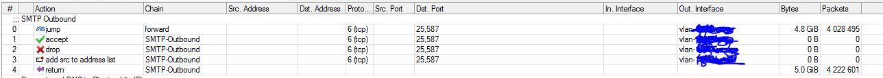

I have tried setting up firewall rules to limit & block spammers with connection limits as per the mikrotik wiki,
the problem is that if I have the connection limit & limit both enabled it does not count at all no matter what I change the values to.
If I remove either the connection limit or the limit it starts counting.
Using a CCR1009-8G-1S-1S+
RouterOS: 6.35.4
add action=jump chain=forward comment="SMTP Outbound" dst-port=25,587 jump-target=SMTP-Outbound out-interface=vlan-interface protocol=tcp
add chain=SMTP-Outbound dst-port=25,587 out-interface=vlan-interface protocol=tcp src-address-list=smtp-bypass
add action=drop chain=SMTP-Outbound dst-port=25,587 out-interface=vlan-interface protocol=tcp src-address-list=spam-block
add action=add-src-to-address-list address-list=spam-block address-list-timeout=1d chain=SMTP-Outbound connection-limit=30,32 dst-port=25,587 limit=30,5:packet out-interface=vlan-interface protocol=tcp
add action=return chain=SMTP-Outbound log=yes log-prefix="SMTP: "
Please can someone assist

Yes they are since the log entry on the return rule picks them all up & I have to manually block them
