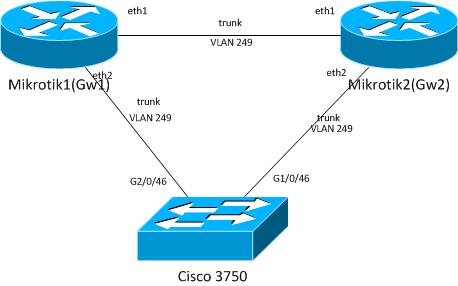

I also could not set up the CCR1036 STP/RSTP with a trunk in a “true” way, all my attempts turned to fail.
For example, I have topology as attachment to this post. two CCR’s + two Cisco 3750 in a Stack mode(working as one switch).
Information about VLAN249 on first CCR:
[admin@dcGw1] /interface bridge> monitor BI_VLAN249
                  state: enabled
    current-mac-address: 00:0C:42:B2:88:B9
            root-bridge: yes
         root-bridge-id: 0x8000.00:0C:42:B2:88:B9
         root-path-cost: 0
              root-port: none
             port-count: 4
  designated-port-count: 2
Information on second CCR
 [admin@dcGw2] /interface bridge> monitor BI_VLAN249
                     ;;; BI_PublicInternet
                  state: enabled
    current-mac-address: 00:0C:42:B2:8C:15
            root-bridge: no
         root-path-cost: 10
              root-port: eth1_vlan249
             port-count: 4
  designated-port-count: 1
Everything looks fine, one of them is beenig root, second one is beening as not root.
But let’s look to Cisco switch output:
SWstack#sh spanning-tree vlan 249
VLAN0249
Spanning tree enabled protocol rstp
Root ID Priority 33017
Address 0022.be9e.b780
This bridge is the root
Hello Time 2 sec Max Age 20 sec Forward Delay 15 sec
Bridge ID Priority 33017 (priority 32768 sys-id-ext 249)
Aging Time 300 sec
Interface Role Sts Cost Prio.Nbr Type
Gi1/0/46 Desg FWD 19 128.46 P2p
Po1 Desg FWD 3 128.488 P2p Edge
Po2 Desg FWD 3 128.496 P2p Edge
Po4 Desg FWD 3 128.512 P2p Edge
Po5 Desg FWD 3 128.520 P2p
Po6 Desg FWD 3 128.528 P2p
Po7 Desg FWD 3 128.536 P2p
Po8 Desg FWD 3 128.544 P2p
Po9 Desg FWD 3 128.552 P2p Edge
Gi2/0/46 Back BLK 4 128.100 P2p
SWstack#
Why Cisco Switch becomes as root bridge - is confusing me.

   Designated root has priority 33017, address 0022.be9e.b780
   Designated bridge has priority 33017, address 0022.be9e.b780
   Designated port id is 128.46, designated path cost 0
   Timers: message age 16, forward delay 0, hold 0
   Number of transitions to forwarding state: 8
   Link type is point-to-point by default
   BPDU: sent 201, received 1397377
SWstack#
SWstack#sh spanning-tree vlan 249 interface Gi1/0/46 detail
 Port 46 (GigabitEthernet1/0/46) of VLAN0249 is designated forwarding
   Port path cost 19, Port priority 128, Port Identifier 128.46.
   Timers: message age 0, forward delay 0, hold 0
   Number of transitions to forwarding state: 1
   BPDU: sent 1291887, received 2
SWstack#
So how two make ONLY one root bridge switch in this topology?
Mikrotik team
any suggestions?
