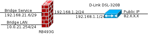

Guess you’re right. here a modified version of my LAN (IP’s have been modified).
The thing is - that the ADSL2+ modem provides through DHCP the public IP 82.X.X.X as IP to the RB493G, and the 192.168.1.1 as gateway for the next Hop as seen in my first post. below a stripped down version of it.

The Problem I have now is that the system will route requests from the RB493G right, but nothing that comes from the other networks, notably “Bridge LAN” and “Bridge Service”.
If I do remove the transfer lan 192.168.1.0/24 from the Bridge-World, nothing works.
It is very honestly the first time I see such a screwed ADSL2+ Modem, however it is the only I managed to get to RUN on the providers ADSL2+ connection, hence I don’t really have another option.
So - what I managed so far, is to have the Router RB493G to talk to my LAN’s Ok, the RB493G also talks to the Internet Ok. However, it can not route the traffic from my LAN’s to the internet and vice versa.
That is what I try to do.
Any Ideas ?
