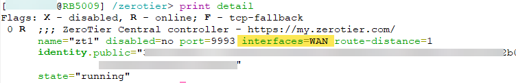

I have it running via WAN
is this the same ass using interfaces in zerotier winbox page ?
Yes, that's the same setting.

Agreed. Or perhaps set interfaces to WAN interface list to limit its searching, since OP looks to be using all which will generate traffic on LAN looking for VL1 paths (and may be what he's trying to avoid).
