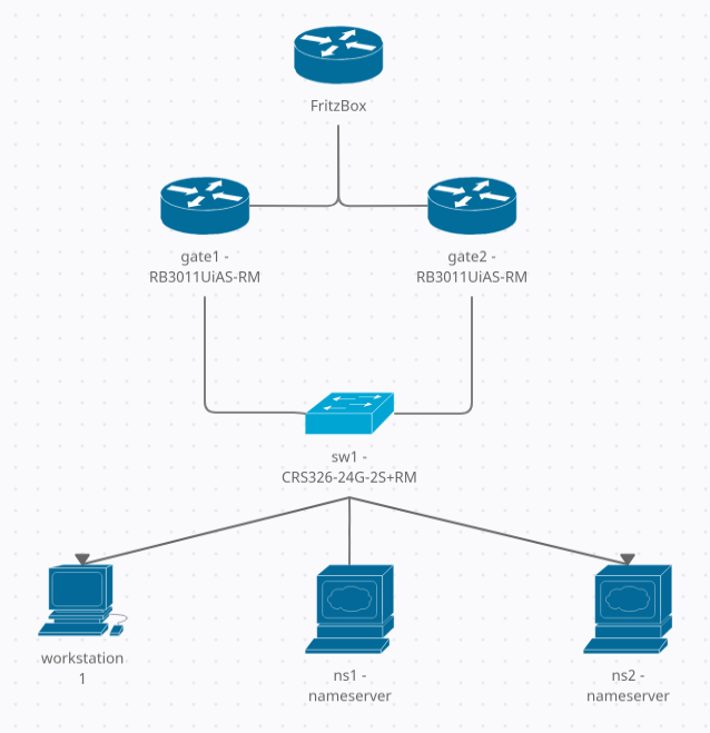

Uplink
My upling is DSlite.
FritzBox
The FritzBox is a FRITZ!Box 7490 provided by my ISP. It handles the authentication and NATting towards the internet.
gate1
I have the gate1 and gate2 redundantly connected via VRRP. This is just to keep in as complete as possible / necessary, but HA does not work as expected atm. gate1 and gate2 are doing another NAT which means that my FritzBox does not know anything about what is behind gate1 and gate2. I unfortunately had to choose this option because I have several subnets and in the past I couldn’t tell the FritzBox the necessary routes (works by now but not yet changed).
gate2
My gate2 is really just idling and not capable of handling all the traffic if gate1 is failing.
sw1
At my switch all me devices are connected which are a few more than in the graph but they are not really necessary.
ns1
ns1 is the primary recursive nameserver (running bind9) which provides internal DNS functionality for me. I have a subdomain only resolved at home so the public DNS servers don’t know about the internal names etc.
ns2
ns2 is the secondary recursive nameserver (also running bind9) - just like ns1.
workstation
A client having both IPv4 and IPv6 addresses assigned.
