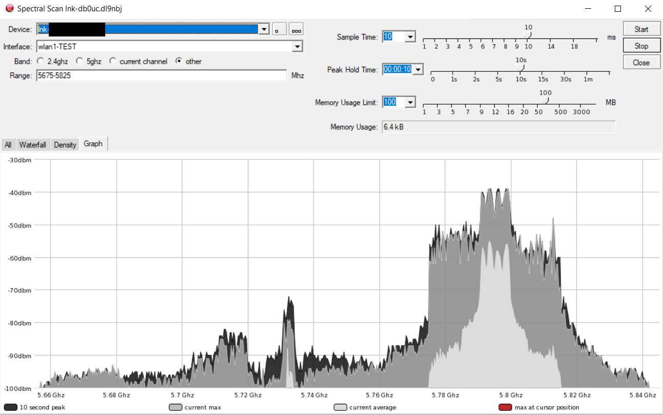

You can view a graphical spectrum with the dude server and the dude client software. It works with all wireless devices, except AC devices.
For this case I am running a dude server as virtual machine in HyperV.
@dl1nux have you tried
/interface wireless spectral-history <wireless interface name>
And
 /interface wireless spectral-scan <wireless interface name>
https://wiki.mikrotik.com/wiki/Manual:Spectral_scan
