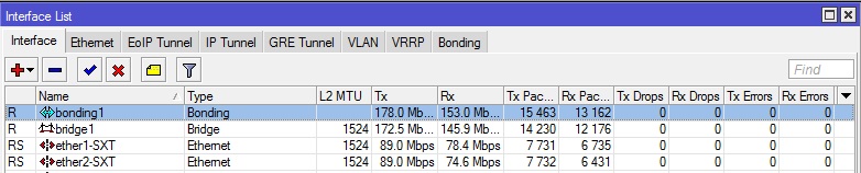

I have one link with 4xSXT in bonding mode. All is goodfor about one day. Speed is ~330mbps but after one day speed decrease to ~200mbps. After a reconnect to both sxt links, no change to the settings, all is fine again. Running 5.11 with nv2. With 5.4 the problem did not exists.
Sadly I have not a picture before reconnect.
downgraded and it works very good with 5.4 so who wants to make bonding should not upgrade.
