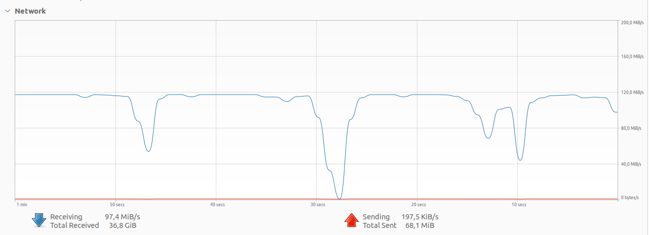

Hello, I have for few years HAP ac2. Recently (2-3 weeks) noticed that when I want to watch movies on my Android TV from smb server. Both connected by LAN cable to HAP ac2 directly. Movie every few minutes stops to play, and I must open it again. I started to test different parts, by few tests I checked that my smb server is ok. Disk reads and writes are constant. So I connected my notebook and PC directly to HAP ac2 by LAN cable. On both PC and notebook I have 1Gigabit ethernet. I tried to copy 30GB file over scp. I was watching speed while copying. I noticed this behavior (see attachment). Every few seconds there is drop in speed just for short time, and every few minutes there is drop almost to speed 0 Mbit/s. I think this can cause that movie playback on my TV suddenly stops. I have router OS 7.13 and I updated around 3 weeks ago. I am afraid that this update causes some instability in network speed. Did anyone noticed same issue ?

It worked fine for more than 2 years. Only since router os 7.13 i am no longer able to watch movies on TV becasue speed drops to zero every few minutes and TV has not enough of buffer to cover this drop in speed.
I don’t mind fluctuation in case there are no drops to zero. And since it worked with cheap DLink router for many years and than it work more than two years with HAP ac2 and problem occures only since 7.13. I don’t see reason to buy switch and had two devices just to cover simple home use case.

Thanks for answer. I tried to downgrade from 7.13 by downgrade button in package menu. It did restart but didn’t downgraded to 7.12 but it suddenly offered update to 7.13.1 so i did this update. I didn’t have time yet to test it properly bud at least i played movie on TV for 40minutes without any issue. With 7.13 it usually crashed playback of movie every few minutes or at least few times per hour. So i can’t conclude yet it is fixed but i will test it for few days to confirm. Meanwhile I will look for CPU and Memory usage. I enabled graphs so i can see memory and cpu usage.
So for now it looks like problem was solved by update to 7.13.1.
