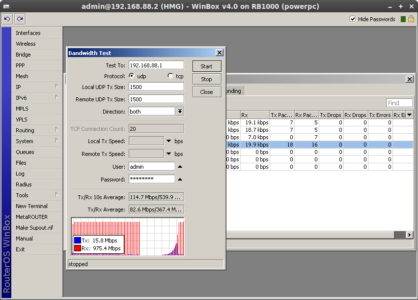

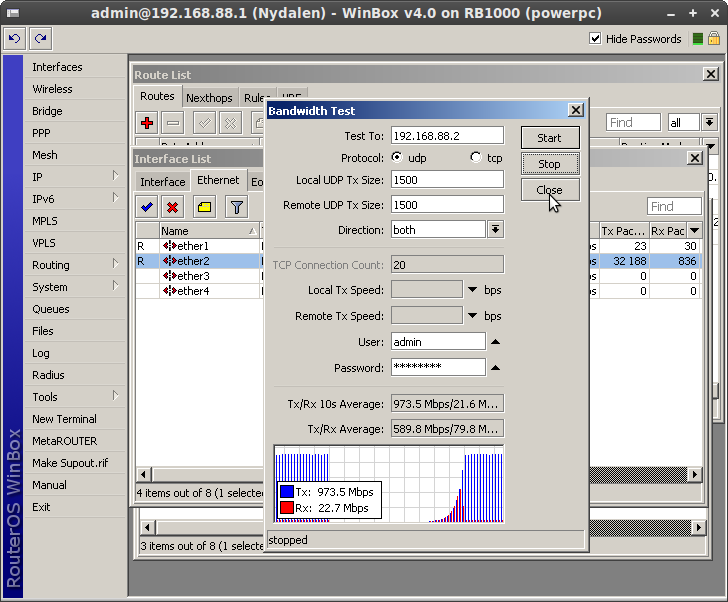

I have two RB1000 connected to eachother, with 1Gb ethernet connection.
When I try to do a bandwidth test, both TX and RX goes up to about 100mbit, before TX speed suddenly goes down to 15~mbit, while RX continues up to ~970Mbit.
Anyone knows why this happen?
It’s no magic on the interfaces, they are not part of any bridges, just plain interfaces. None of the devices has any firewall enabled.
I tried the other way too, and the RX and TX actually swaps, so seems like consequently TX on one box, or RX on the other is having problem?
Switching cables did not have any impact.
Screenshot-admin@192.168.88.1 (Nydalen) - WinBox v4.0 on RB1000 (powerpc).png

AND, I have tried running the test (displaying) from both routers, and it’s the same direction that dies. Like it would if there was problems with one pair in the tp cable, or the network device. But I have tried different ports and cables. With same result.

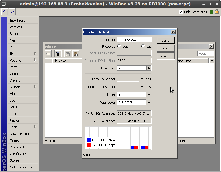

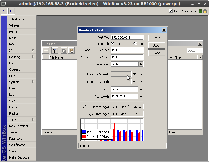

I have set up one more router now. So I will try to check speed A->B->C.
This is the result for A->B->C.
Router B is just set to Soft Bridging A and C with no fw enabled.
Is this within expected results for a soft bridge with 1500byte packets?
With TCP, i get ~139mbit both ways.
Screenshot-admin@192.168.88.3 (Brobekkveien) - WinBox v3.23 on RB1000 (powerpc)-1.png
Screenshot-admin@192.168.88.3 (Brobekkveien) - WinBox v3.23 on RB1000 (powerpc).png

In the A<->B<->C test, the CPU status is as follows:
A = 40% CPU (Bandwith tester)
B = 40% CPU (Bridge)
C = 99% CPU (Btest server)
Average 515mbit in and 360mbit out
Testing C<->B<->A:
C = 67% (Bandwith tester)
B = 41% (Bridge)
A = 35% (Btest server)
Average 400mbit in and 522mbit out
I still think this is weird. Disagree?
I saw that I had forgotten to upgrade router A to RouterOS 4.0.
Now that I did that, instead of ~500mbit both ways I’m seeing the 900Mbit out 25mbit in issue from A->B->C !
So something big in either the bridge or the bandwidth tester has happened between the OS shipped with the routers, and the latest 4.0.
A = 19% CPU
B = 44% CPU
C = 100% CPU
Now, when I test from C i get the following, more concequent data:
C = 100% CPU
B = 44% CPU
A = 19% CPU.
Why is it that, both A and C routers are clean, no config, just firmware upgraded. Have so different cpu usage?
