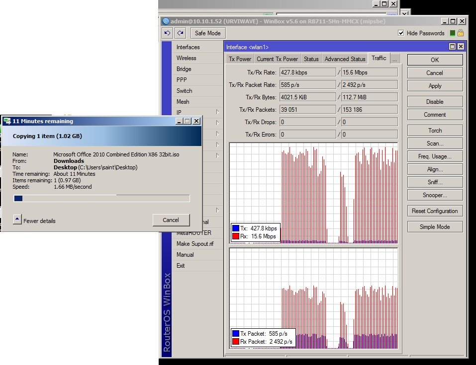

i have setup a small test link in my house and the antennas are hardly 20 meters apart. i tried to do a FTP from machine to machine but could not achieve speeds above 1MBPS. bandwidth test shows around 80MBPS.

the transfer at actual and speed as shown by routeros
