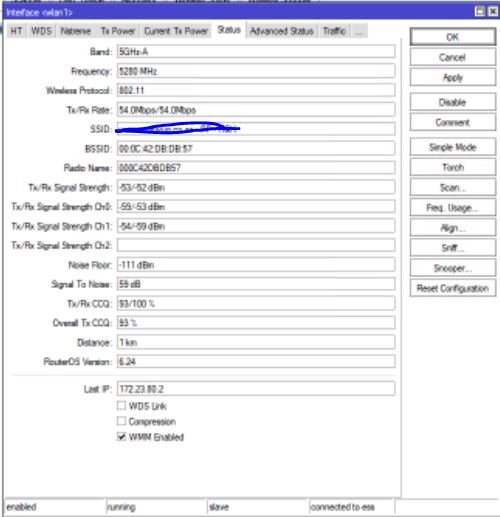

I have successfully connected a RB SXT SnD r2 to a RB Omni TIK U-5Hnd. Everything is working fine.
I am just trying to find out if I can do anything about the speed of the connection? The alignment is pretty good ( I think ). All I manage to get is 54Mbps.
I have attached a picture of the status window.
Any assistance would greatly be appreciated.
Regards
Ryan
Try using band N instead of band A.
Thanks very much. That worked.
