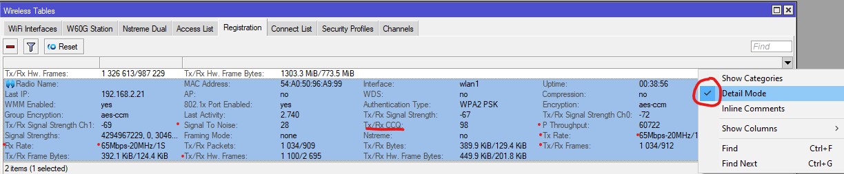

So, I tweaked some settings (setting the channel in CAPSMAN to “onlyn”) and managed to get ~120Mbps (see attached). That’s definitely much better than before; still not what I feel should be possible, but better.
Testing was performed using iperf between a WiFi client on AP2 and a wired LAN client on AP1.
Could you give me a steer to find where I see this?
Ahah, Wireless > Interface (wlan1) > Status. See attached.
It moves around a bit, between 70% and 102% (?).
Just to add, I have 44 connected wireless clients (mostly ESP8266 smart home stuff), so they may or may not be helping legitimate internet use :slight_smile:
Winbox:
or: via CLI
interface wireless registration print stats
