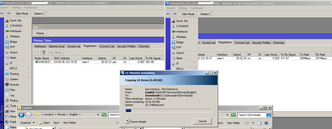

speeds not going above 10MB/s
i have 2 Dynadish in a range of 2.5 kms.
i am using NStreme protocol and the signal is around -60 to -70.
when i start a file transfer the start is around 16MB/s but immediately drops to 10MB/s and then settles there. does not increase nor does decrease.
how can i get more speed out of the link?
i did try using NV2 but then speeds drop below 10MB/s and are around 5MB/s…
Your link is not aligned correctly. Major mismatch in the chains.
thanks for the reply… so a realignment and the signal level if matched will push the data speeds above… will they?
You want to get as close to -55/-55 in both chains as far as possible. It will help with modulation rates and you may get faster speeds.
hahah! :slight_smile: thank’s for the help.
on a lighter note… :slight_smile: you mentioned the word “may” which means are you doubtful?
I mentioned “may”, as wireless speeds are dependent on many factors such as line of site, freznal zone, noise etc. Signal and good chain signals are probably the biggest determining factor - so get those sorted out and work from there
yes… true… i did that and it helped me a lot. :slight_smile:
i owe you one!!
