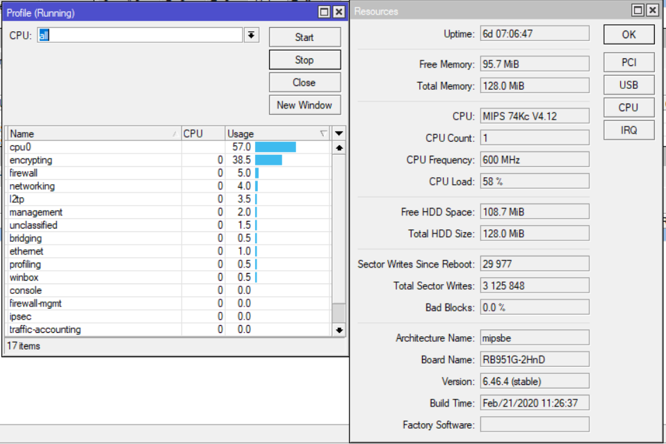

The problem I currently have are ping spikes over a lan network and some packet losses.
This network just a few months ago was 0-1ms pinging from devices on the same subnet.
I also have some increased ping times between the two location routers but at this point
I believe it is happening due to an issue at the location 1 router.
Changes:
We recently added 4 new Amcrest IP security cameras.
I thought these devices were the culprit
but disconnecting the cameras physically only lessened the CPU usage
on the router and lowered the ping times just a little.
Besides this I can’t really see what is causing these high pings and packet losses.

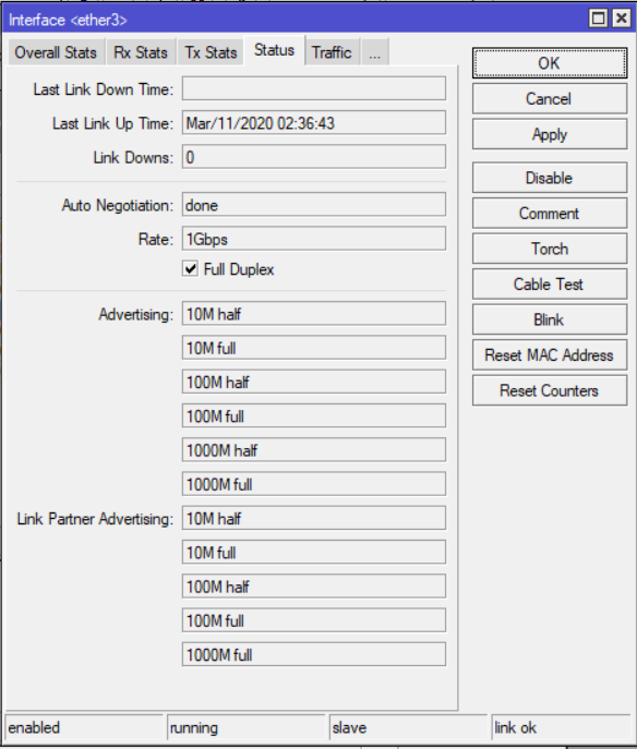

[josh@Warehouse Main1] > export compact

One thing I did find odd when exporting the config was that my ethernet ports are all set to 100mbps!!
Not sure what that is about!
set [ find default-name=ether1 ] speed=100Mbps
set [ find default-name=ether2 ] speed=100Mbps
set [ find default-name=ether3 ] speed=100Mbps
set [ find default-name=ether4 ] speed=100Mbps
set [ find default-name=ether5 ] speed=100Mbps
Oddly within Winbox the ports that are live are set to gigabit.
Ethernet port speed settings are not of concern as long as ports are set to auto-negotiation=yes and the advertise= is set appropriately.
Other than that, you’re really stretching your RB951G devices: you’re disabling switching in hardware (by setting hw=no), forcing all traffic through firewall (by setting use-ip-firewall=yes). And keep in mind that RB951G does IPsec encryption in software.
What does /tool profile show? What is CPU load?
Hey Mkx,
thanks for the reply!
IP Firewall, I just recently turned this on to see if it alleviated anything.
It looked like it did but I don’t have a ton of knowledge concerning it.
CPU Load ranges from: 40 to 70% with IP Firewall Off
CPU Load ranges from: 20 to 60% with IP Firewall On
These fluctuate wildly but never hit 100% or even 90% on either setting but I do believe I see spikes in ping when these higher percentages are seen
See picture for
Profile tool
I have figured out that encrypting is related to my vpn,
however I would think this would drop when I kill the cameras manually when unplugging and or use a firewall rule to block them.
Note: the 4 camera’s NVR is at location 2, so camera traffic when allowed is going over the vpn which
i would expect some load from encryption but I would also expect this would drop
when I kill the cameras and or use a firewall rule to block them, however this has not been the case.
The loads persist and the pings are still spiking from 0ms to as high as 300ms(usually around 150 ms are the spikes) at each subnet(router).
