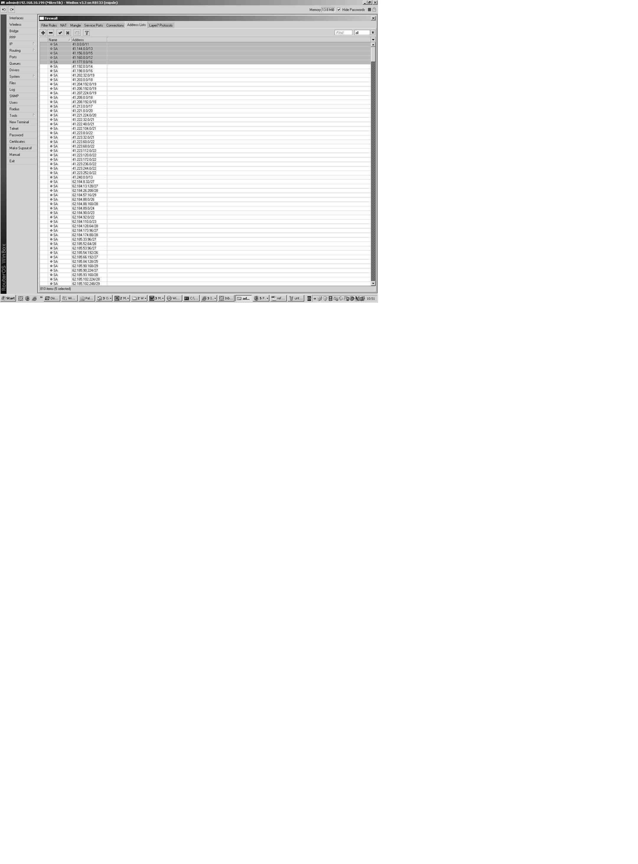

I’ve been trying to split the internet traffic accross two differnetn ADSL accounts - the one for local (within country) traffic and the other for international.
I spent hours yesterday but with no success.

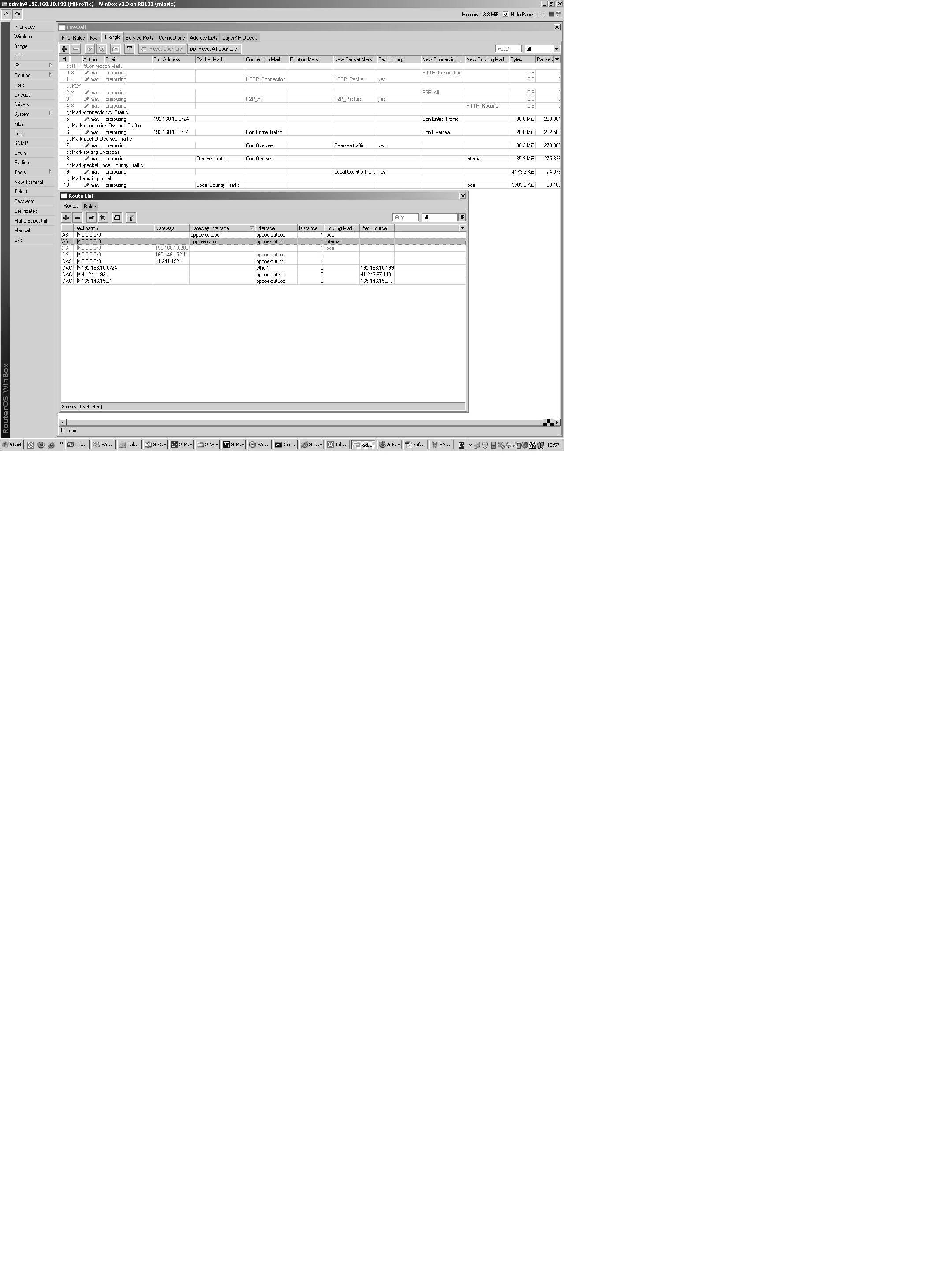

I’ve created the Address List of local ip’s under the Firewall and tried marking the packets for routing under Mangle. I setup two gateways (using Gateway interface) for my two pppoe accounts (one local only and the other international only) but both using same ethernet port connected to ADSL modem. But still get packets going over the wrong route. Using Router OS 3.3
Any ideas please?

Ok, just watched the video and all that was done was a bunch of local IPs were added to the route list and the pppoe connection set to “no default route”.
I was expecting a way more complicated setup with fancy mangle rules and packet marking etc.
Is it really this simple?
For a basic setup you do not need mangle rules…but if you want to send different source ip through specific gateways then you will need to use route marking…
But yes, it is that simple…
