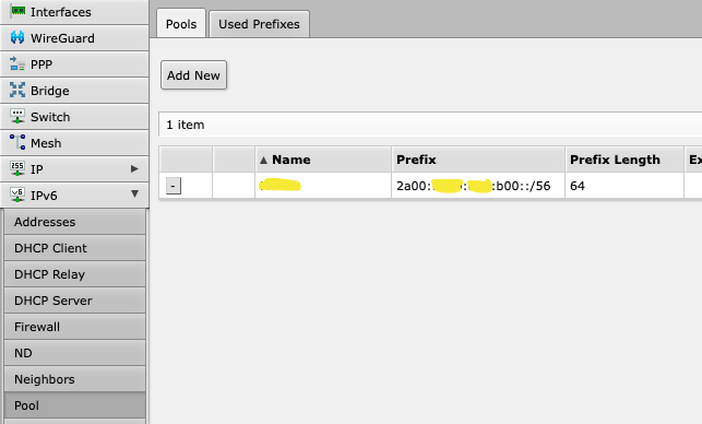

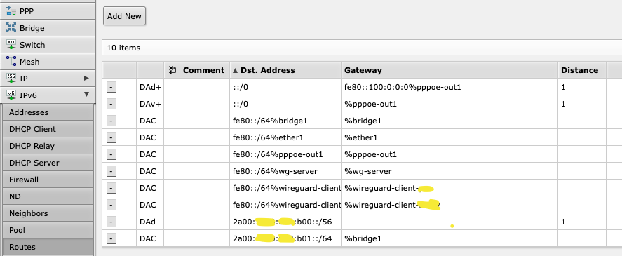

So here is my current config on screenshots. Should I remove 2a00:1234:567:b00::/56 from IPv6/DHCP Client (last position in the table) and from IPv6/Pool/Pools?
As you can see I’ve already cut out one /64 from it and added to Addresses, IPv6/ND/Prefixes and IPv6/Pool/Used Prefixes however devices in the local network are getting addresses from 2a00:1234:567:b01, 2a00:1234:567:b02 and 2a00:1234:567:b03. b02and b03 are not configured so I am guessing they are obtained from b00::/56
If I configure DHCP server for IPv6, will only defined hosts get IPv6 address? What else should I change?

MikroTik does not support DHCPv6 to distribute individual addresses. So you cannot do that.
You can use DHCPv6 to distribute prefixes, e.g. when you have a down line router you want to pick a /64 from your /56 pool, you can setup a DCHP server with the pool you obtained from PPPoE and re-distribute parts of it.
But for local address assignment, SLAAC is your only option (at the moment), no DHCP.
Ok, so is it possible to exclude some network devices (Chromecasts) from obtaining IPv6? It is unfortunately not possible to disable it on Chromecast itself.
No, you only can attempt to filter their internet access and they will fall back to using IPv4.
