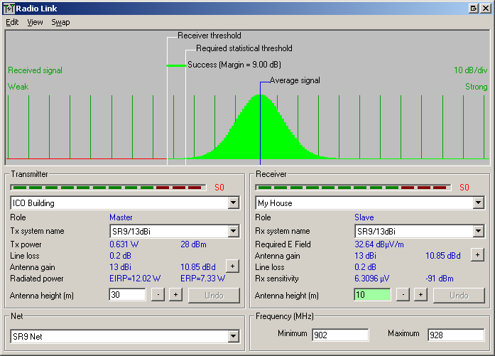

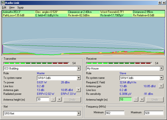

Another thing I’m curious about is signal levels. With a noise floor of -98dB, should -86dB signal be enough for a reliable connection? According to radio mobile, the link is good:

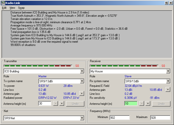

and indicates that I’m 9dB over the 99.8% reliability margin:
See 3rd attached image for link tool details.
Predicted signal is -82dB, but I’m losing an additional ~4dB due to foliage (it was expected). At the moment, one of my cards has a weak transmitter and is being received at only -93dB, so I can’t tell if it’s going to be stable through experimentation - plus, I’d like feedback from experienced 900Mhz users.

I’ve found that if the signal isn’t into the low 70’s, you’ll have issues.
Cell phones interfere, power company in AL, dunno what they use in Kansas.
With 2.4, I like my customers in the -70’s, but I’ll let a low -80 slide if its the best I can get. On 900MHz, the noise floor hits -80s quite often here. I’m going to install a cavity filter next time I go up and see how that works out, but even when the noise isn’t that bad, 900MHz just doesn’t work as well as I though it would.
Thanks for the reply :slight_smile:
I hope that’s not the case, but I’ll just have to find out. I have a few options though, as I can move the 30M side up to about 35M if I really have to, but that moves the Fresnel >1.0 … but I’m not sure it will matter, because I have lots of trees on the client side to deal with. Basically I have to blow right through the canopy for about 2 blocks.
Regardless, I don’t think I’m going to be able to get better than about an -85 signal.
900Mhz cell phones are going the way of the dodo bird here.
Our power company is Westar Energy
I’m showing a noise floor of about -98 or so on the 900Mhz - which I found very impressive. I have heard so many reports of terrible noise floors on 900Mhz, I was expecting it to be MUCH worse. Maybe I’m getting a good noise floor in relation to what others get because this is a point to point connection with 13dBi Yagi’s. Regardless, I should be able to get an SNR of >=10dB.
My goal is to disconnect my cable modem connection so I can save money, and be back on my own network. It wounded my soul when I moved and couldn’t get my own DSL or 2.4Ghz wireless :frowning:
