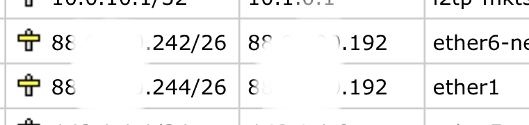

88.. .242/26 ether1 (routing-mark wan1) and 88.. .244/26 ether6-net5 (routing-mark wan2)

The two WAN ips are located in the same subnet, but my isp offers me an virtual mac-address for each ip. Without this, it will not work.
Do i have to set booth rules? Mangle and NAT?

Yes, that’s correct they provide for each IP another MAC address. The router os is running on a kvm hypervisor.
And this was my fault. Wan1 is .244. And wan2 .242
So it was already the correct ip but will not work.
