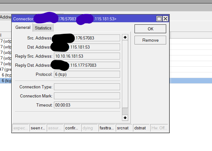

However, the problem arises if I try to access that IP inbound I don’t seem to be getting where I need to be. Or I suspect more specifically not getting back out correctly. If I try to make an inbound connection and look at that connection I see the following which I think is showing that the traffic is coming in but that it’s trying to go back out wearing the XXX.XXX.115.177 IP rather than the XXX.XXX.115.181 IP that it should be (ie. reply dst address).

I would specify the out interface (or interface list) for the src-nat rules.
I guessing we havn’'t seen the full nat table yet, have we?
