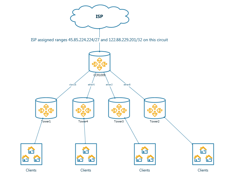

SRC NAT to WAN IP without the IP existing on any interface?
Does WAN/Public IP addresses have to be assigned to any interface of the core or edge router?
Here is my topology
And here is my config:

So, my gateway is set to 122.88.229.201/30 (the ISPs router)
All is working fine.
