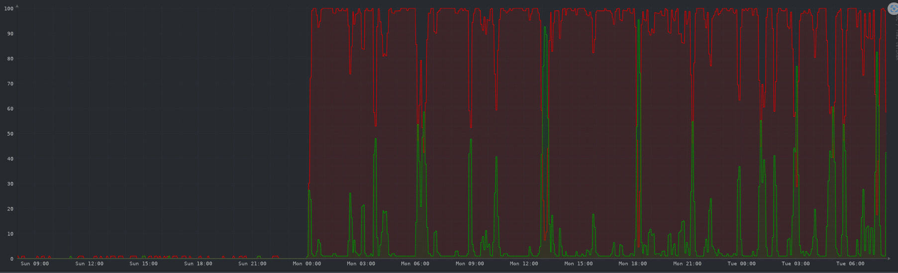

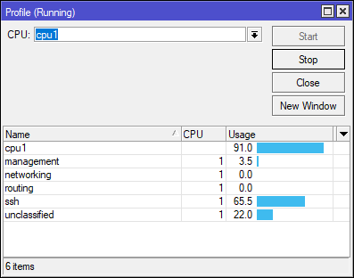

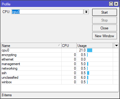

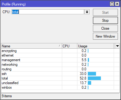

I noticed that the CPU usage on at least one core is consistently extremely high when this error occurs. However, connecting to the devices using WinBox still works without problems.

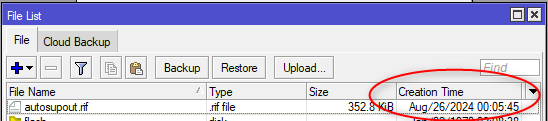

What I also noticed is that an “autosupout.rif” is generated on every device at the time the error occurs. I will now submit another support request to Mikrotik in parallel with the “autosupout.rif”.
