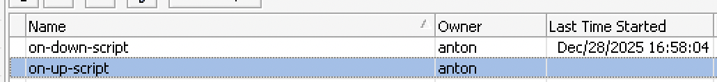

Have you tried to set script owner?
not a good idea.
What if 2 OpenVPN users connect simultaneously?
yes it is there

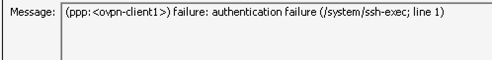

When I run
/system ssh-exec address=linux.server user=root command="/sbin/iptables -A INPUT -p tcp -s ${caller-id} -j ACCEPT"
directly from PPP → Profile → Scripts → On-Up,
the SSH connection does not use any user SSH key.(I checked this from the Linux server side, and according to the SSH logs, MikroTik attempts password authentication first. Since no password is configured, the authentication fails.)
There is no way to identify which SSH key is used, nor to upload or select a key for /system ssh-exec.
(at least i cannot find a way)
