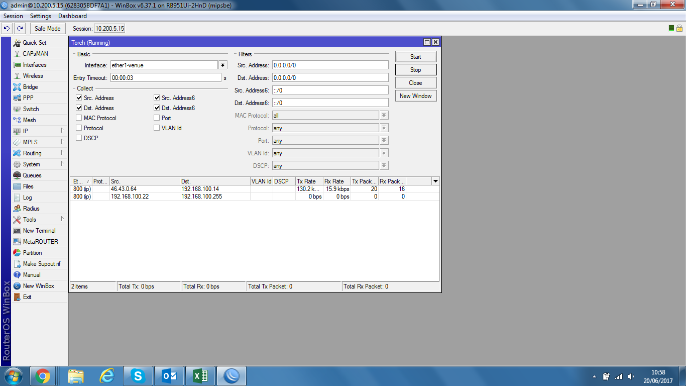

attached is a screenshot of one of the miks running torch

Torch is the wrong tool.
Use Scan or Snooper from the w/l interface menu.
Starting a scan or snooping session will disconnect all users from the wireless interface.
-Chris
also we run capsman on all boxes
AFAIR these features haven’t found their way into capsman yet.
So you’ll need to connect to the AP directly, disable the CAP function and then start the Scan or Snooper session there.
-Chris

Btw, if you run scan with background box checked, you won’t drop clients but it will slow them down.
Depending on your needs, you could add a dedicated router for monitoring purposes only.
