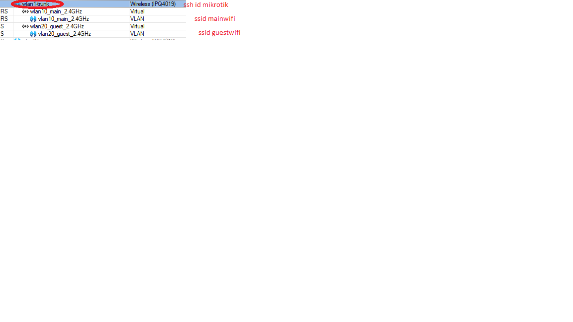

I am using tagged networks 10 for main lan/ 20 for the guest lan they assigned to virtual wlans
2 virtual aps - 10 for main lan/ 20 for guest accordingly
it all works however, there is also real ap, sort of wlan1 and it has a default ssid mikrotik, I don’t need it as it at all and I asume on vlan1, but if i disable the wlan1 the virtual go down as well
What can I do can it just not use ssid at all?
Real wlan interface has to be up&running for virtual ones to work. So why don’t you change settings of real wlan interface to one of needed ones? You’ll end up with one real wlan interface and one virtual wlan interface for total of 2 SSIDs.
