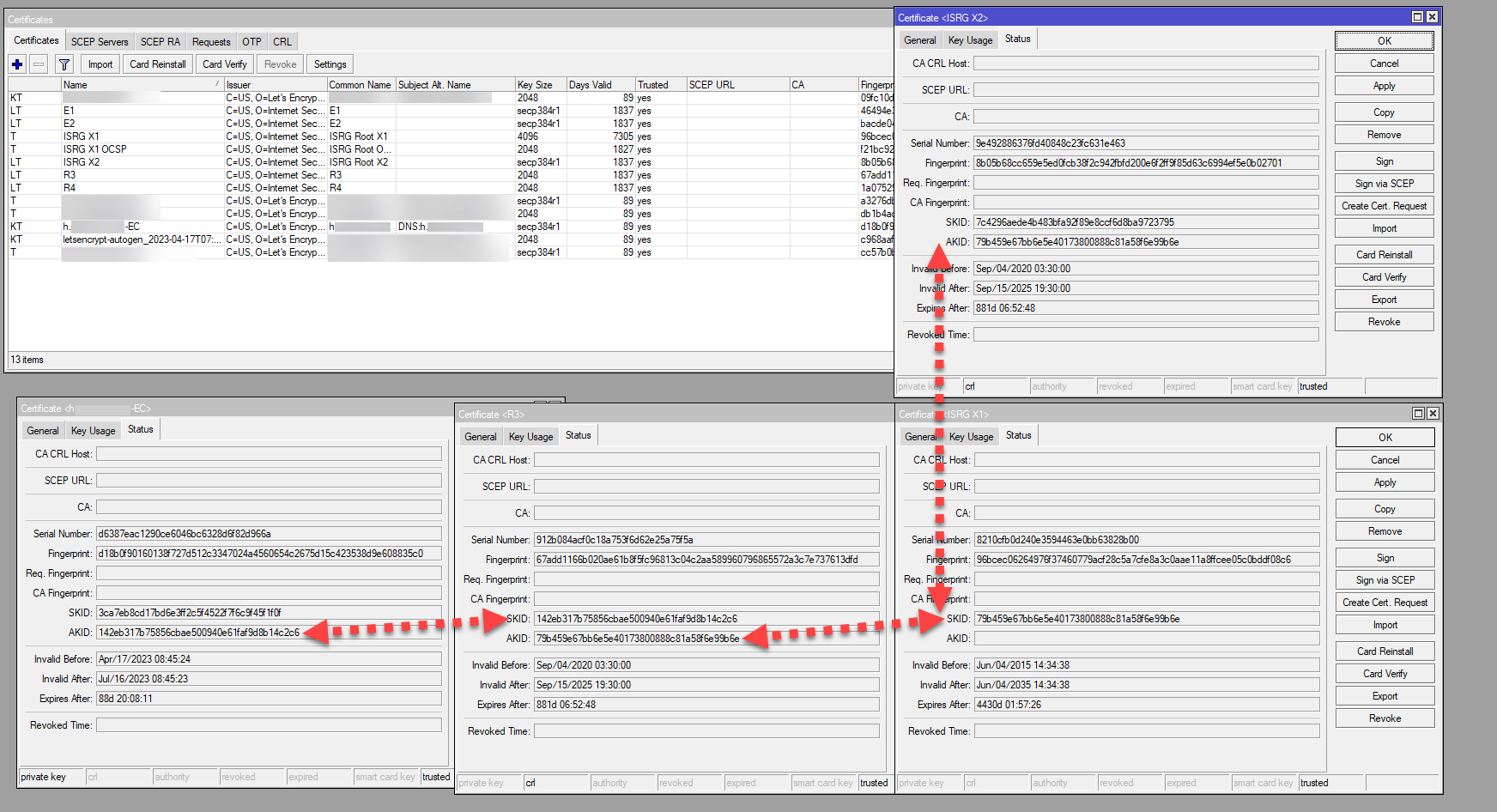

How are you generating the certificates for the SSTP server? Are those certificates marked as trusted on both ends (if they’re not from a trusted CA)?
I’ve had a lot of trouble when using self-signed certificates or certificates signed by a MikroTik Router setup as a CA. The trust problems were solved by importing the public certificate (and/or CA public certificate) to the client device and marking it as trusted.
Let’s Encrypt & CF API
Yes
