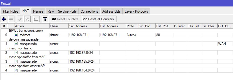

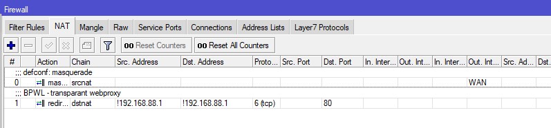

The local LAN (192.168.87.0/24) but also incoming SSTP links from my mAP’s (remote access to this TURN service coming in with address 185 and 186) all go out as 192.168.187.1 to the remote site with SSTP address 192.168.187.2
The remote Mikrotik is connected to the remote network with NAT and firewall set , just as a WAN port is towards internet. This means that all trafiic sent will come from the local WAN port (=remote LAN) address.
In addition of all this I use the webproxy and force all HTTP to use the proxy. This again creates a more local access (not really needed) but has improved the interaction considerably. (There is no caching on disk, but the TCP session reuse of the webproxy apparently helps a lot)

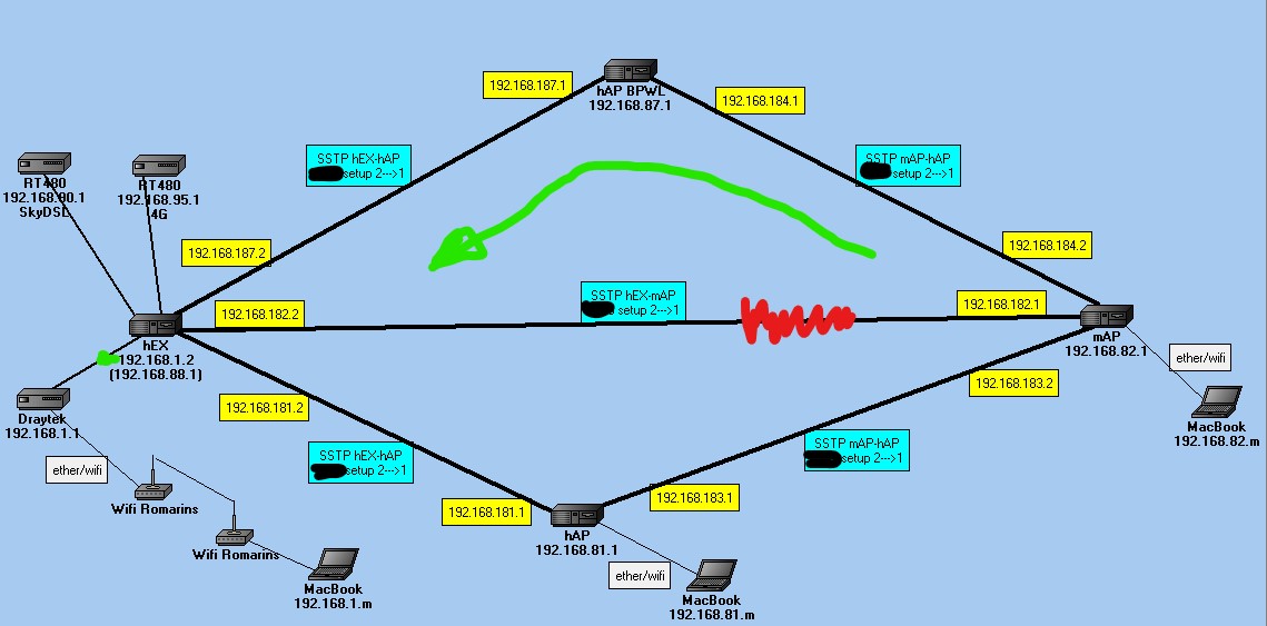

Two hAP Lite as “TURN” server or management sites. The mAP can use either of the hAP Lite to get into the remote site while using a local 192.168.1.2 address.
The masquerades make sure the return path is found by the client devices. This also protects the management environment, together with the default WAN firewall rules in the hEX (DUDE server :slight_smile: )
The SSTP tunnel to the mAP directly is not guaranteed, as on foreign networks the port-forwarding is missing. Therefor the use of the “TURN” function in the hAP Lite’s. Works great!

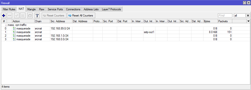

Ok I think I’m making some steps towards the solution. I set the firewall rules as you said both ways, this is the local router (the local network is 192.168.0.0):

I don’t think you can set this both ways. Normally you access from your local network to the remote network with masquerade.
You masquerade the local LAN addresses (192.168.0.202/24) to the SSTP_ address. (Whatever that is)
The remote site receives initiation requests from this SSTP_ address and put them on the remote LAN, masqueraded with the remote LAN port (defined as WAN port in RouterOS) IP address (192.168.1.x/24, whatever address that interface got, might have used DHCP client to get it from the remote LAN)

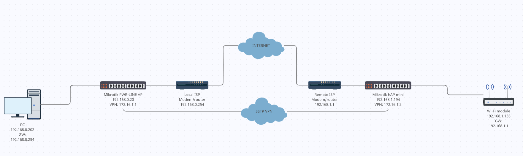

At the moment the network configuration is like so (the local PwrLine is temporary, it was the only device I had at home, and of course there is a switch connecting PCs, ISP, PwrLine)

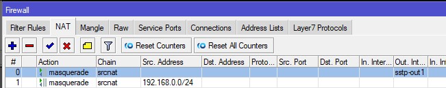

I set the firewall rules of the local MT like this. bridge-lan is the only out interface I can set, if I set ether1 it tells me I cannot use a slave interface (same on remote).
Remote MT firewall has only one rule: masquerade srcnat with bridge-lan as out interface.
Local SSTP server is enabled, remote SSTP server is disabled. Remote client is enabled, and it can connect (it shows in the route table).
It doesn’t work, did I do everything correctly?
Even if I manually set the default GW of my PC to 192.168.0.20 (which should be the scenario you described), it doesn’t work.

  2. The traffic we send from local to remote through the tunnel will be NAT/masquerade’d.
    So the NAT rule translating the traffic from the local LAN source address 192.168.0.0/24 is needed. The reverse NAT rule for the remote LAN addresses 192.168.1.0/24 should not be there !

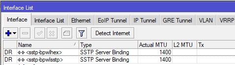

    The name of the tunnel interface is not SSTP-out1 at the SSTP server side.
    The second NAT rule (with index <1>) is what you need. The first does nothing (no such interface) , and the third one should not be there.

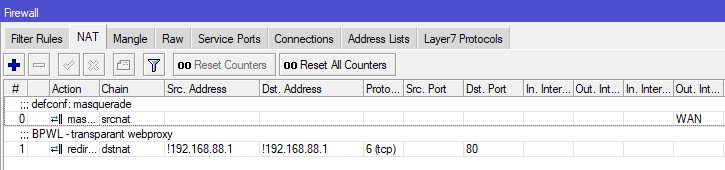

My remote firewall/NAT setting:
With default firewall rules (and some extra rules for the public list). The remote LAN is on ether3.

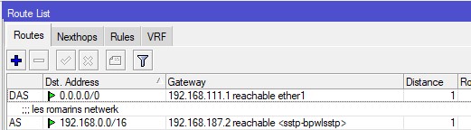

4a: in the local MT a dedicated route via the SSTP tunnel is needed (setting the SSTP client IP address as gateway) for all addresses on the remote site.
