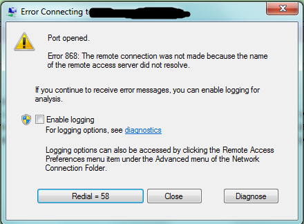

I have a RB433A device with RouterOS 5.11. I have been running SSTP (with RADIUS auth) successfully for a while now, everything was OK until recently, when my wife (we both have Windows 7) could not establish SSTP VPN any more. She would get the error, shown in this screenshot:

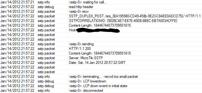

On RB433A, the this error is shown in the debug sstp log:

Any ideas? I Wiresharked both TCP sessions of connection establishment, however the SSL error is sent encrypted back from the server, so I can’t read it. Perhaps I’ll try with ssldump to see what actually is sent over by the server to the failing clients.
However, can anybody help me with the “recvd too small packet” error?
