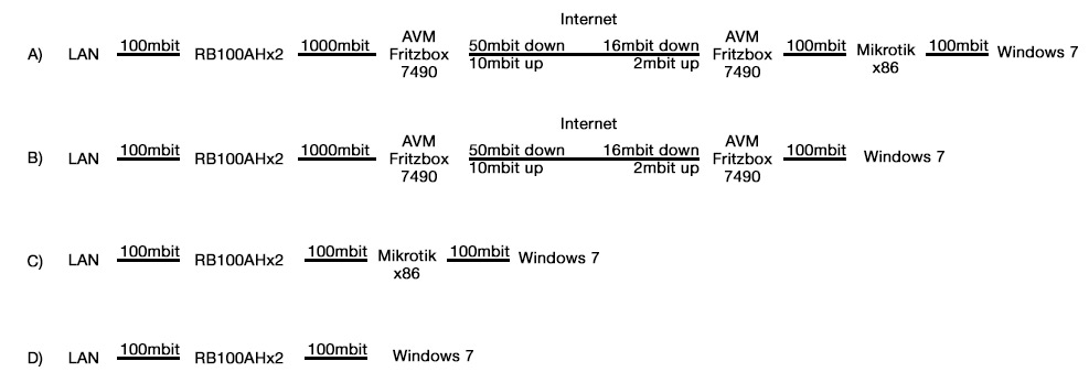

I’ve drawn the layout in the file attached, so to sum it up, the main site has a VDSL-connection with 50mbit down and 10mbit up and the client site has ADSL with 16mbit down and 2mbit up.

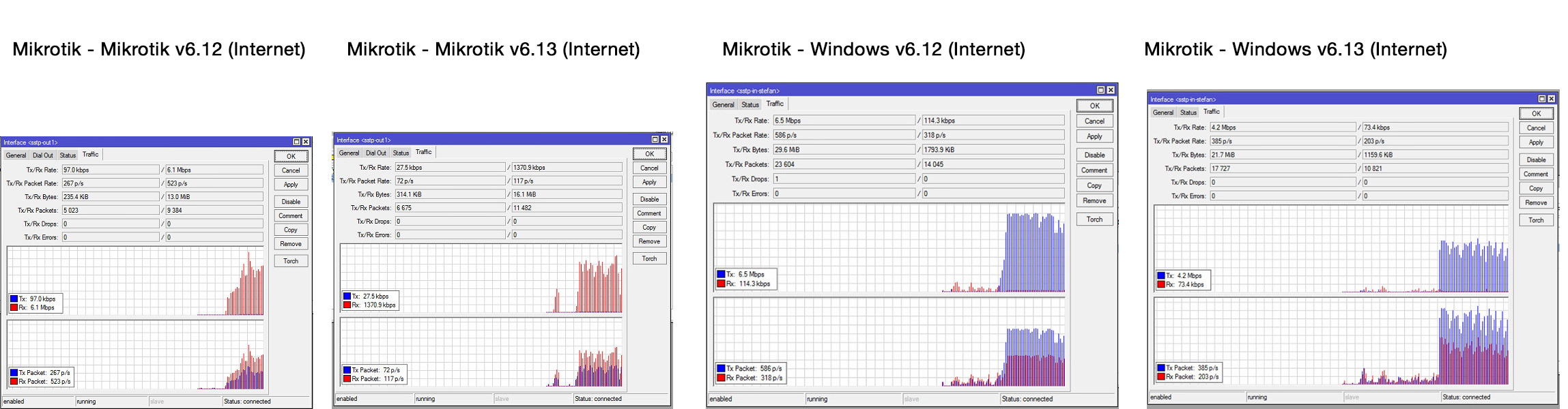

So, with version 6.12 the speed of the link (main-site > client) is about 6Mbps, what’s maybe less than it could be but that’s fine. (see wan.jpg a)
That’s when using Mikrotik on both ends of the VPN and a Windows 7 machine behind the Mikrotik Client. (See layout A).
When I now switch both Mikrotiks to 6.13 (or 6.14rc) I get result about 1500kbps (like shown in file wan.jpg b) and that’s really too less to work with.
If I know replace the Client Mikrotik Router with the Windows 7 PC directly (layout B), though connecting with the Windows machine by Microsoft-SSTP-Client to the RB1100AHx2 that’s working pretty well and faster. It’s about 6.5Mbps with Version 6.12 (wan.jpg c) and about 4.5Mbps with Version 6.13 (wan.jpg d). So the effect that 6.13 has on the speed is much less with the Windows SSTP Client but still definitely to see.

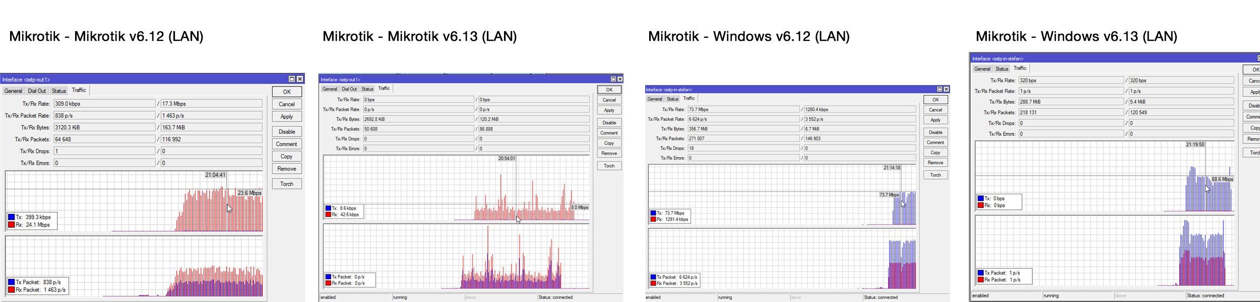

The next setup was to replace the WAN-Link with a 100mbit LAN Link, so there won’t be any issue at provider side I can’t see (Layout C & D). And in fact it’s really faster but the difference is again quite big.
Layout C
While I get a speed of about 23Mbps using Mirkrotik at both ends with version 6.12 (lan.jpg a) I only get less than 8Mbps with version 6.13 (lan.jpg b).
Now again, replacing the client Mikrotik with the Windows SSTP Client I get way better results. (Layout D)
With version 6.12 I get about 73Mbps and with version 6.13 I get about 86Mbit… That’s both fine and don’t differ too much. (lan.jpg c/d).

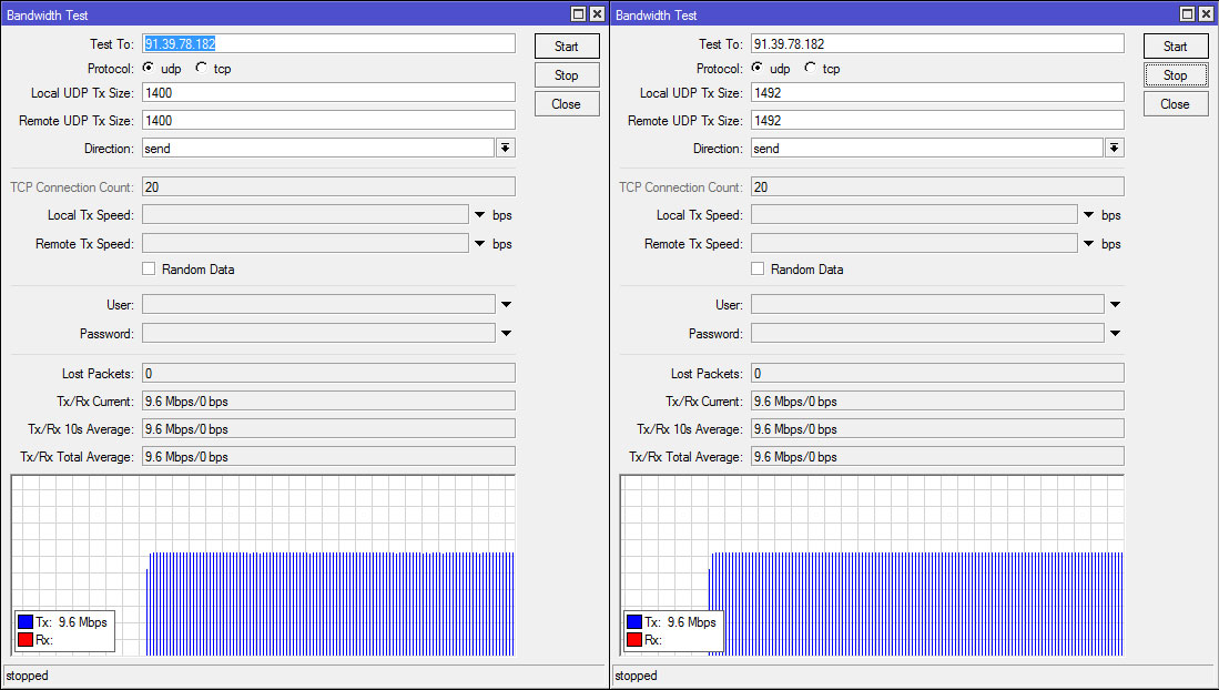

What speed do you get when testing with UDP bandwidth test and packet size around 1400?
Hi, it’s working with 9.6Mbps up to 1492.

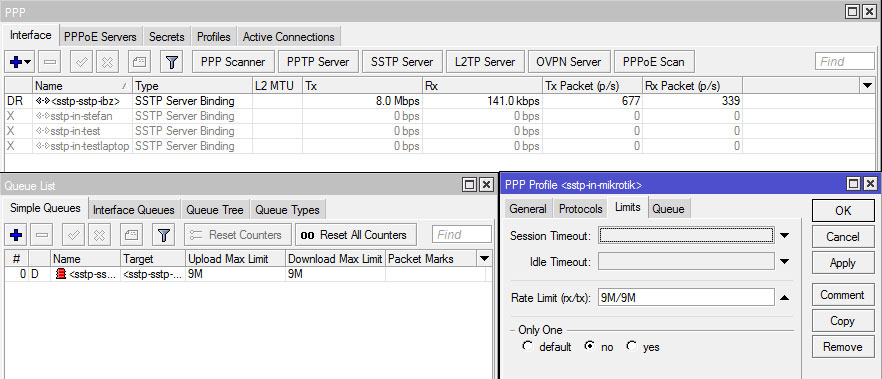

In 5.26 I noticed if I set a rate limit for the ppp profile I never got over ~ 2mbps … and that’s was similar to the stuff above. when I set the buffer of the default small queue up to 50 (I think it was 5?) then I suddenly got more throughput (up to the 10mbps i wanted…).
In 6.15 it seems to have something in common but not exactly the same.

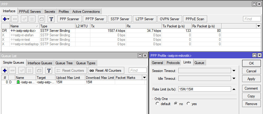

I also set up the default-small queue to 50. But without setting a rate limit in the profile it still stuck with 2mbps.
with 6.15 I HAVE to enable the rate limit and set it BELOW the maximum possible transfer speed of ~10mbps.
As proof:If I set it to 15M like in the screenshot I only get the ~2mbps… as it started with 6.13.
I really have to set the rate limit so low that the router has to start queueing. Otherwise it’s not working fast enough.
And though I finally get quite a great percentage in throughput but not all I could get.
