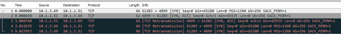

Here is Wireshark capture of failed attempt to start Remote Admin session via SSTP.
10.1.3.69 - SSTP Client, 10.1.1.51 - PC2 with Windows 10 (latest version and all updates) ,MikroTik SSTP server IP: 10.1.3.254, MikroTik LAN IP: 10.1.1.250
Please, help, I’m going crazy…
Client sends SYN and server sends back SYN,ACK. But client sends SYN again, so it looks like it didn’t receive the first SYN,ACK. If that screenshot is from server, then look where exactly the SYN,ACK gets lost (logging rules on MikroTik router can help you). If the screenshot is from client, then it’s really strange, because it clearly received SYN,ACK (it could still be dropped by client’s firewall, but since it’s reply for connection originated from client, it would be very unusual firewall config).

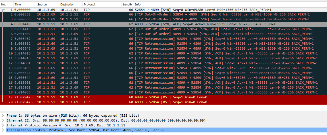

attached capture made on MikroTik when SSTP Client PC1 tried to connect to PC2 with RAdmin.
PC1 10.1.3.69 Radmin Client → PC2 10.1.1.51 RAdmin Server

Latest capture was done on router. TCP out of order - is it ok for first packet was was intended to start tcp session?
That’s not a precise enough indication. When any packet passes through the Mikrotik, it passes through at least two interfaces, the physical one through which it gets in and the physical one through which it gets out, and is captured (sniffed) at both unless you specify a particular (list of) interface(s) to sniff at. And as Mikrotik uses pcap format when sniffing, there is no way to tell at which interface a particular packet in the file has been captured.
So it is most likely that the triplets of packets just hundreds of microseconds apart are actually the same packet captured at different interfaces. So I’d recommend you to sniff once again and indicate the interface closest to the client, which should be the SSTP server virtual interface if I understand your scenario right. My assumption is that there is a bridge on the LAN side, so you capure the packet once at the physical etherner, second time on the bridge, and third time on the SSTP server virtual interface.
I’m afraid that, as said above, there is actually no real packet out of order because the second and third packets in each burst are there only due to the sniffing configuration. But Wireshark has no information allowing it to identify that situation.
Given that you can ping the PC2 from PC1 via the SSTP tunnel but cannot establish a TCP connection, and according to the capture PC2 does answer, I would expect the SSTP tunnel to have some trouble delivering the ****
SYN,ACK
answer of PC2 to PC1, or PC1 has some problem to receive it.
The ****
SYN,ACK
packet is so small that it cannot be a MTU issue (unless you have done something really ugly). So I would try to sniff one more time, at the SSTP server virtual interface and at the internet-facing interface, to see whether the plaintext ****
SYN,ACK
packet from PC2 is followed by an encrypted packet from the Mikrotik’s WAN address to the public address behind which the PC1 is (most likely) NATed. Just don’t be surprised if the encrypted packet seems to be sent before the plaintext one, there used to be some issue with timestamping on Mikrotik and I don’t know whether it has already been fixed.
Based on the result (use display filters to show only the two sessions of interest before posting the picture), we can think further. Also, the same capture with PC3 instead of PC2 would be a good source of information for comparison.
