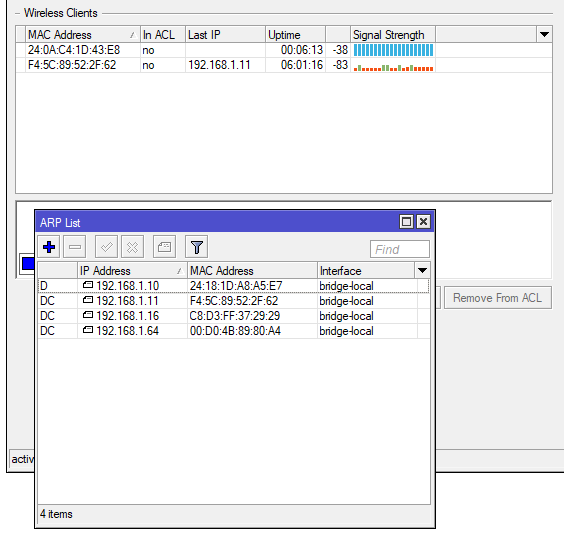

I have a Wifi module (Espressif ESP32 module) connected to my MikroTik router hAP ac firmware 6.42.6
When powered, the device connects to MikroTik AP and obtain an IP address but device is unreachable also using simple ping from other PC on the same network
Under WinBox tab QuickSet in the window “Wireless clients” the ESP32 device is listed with his MAC but IP address field is empty. and in IP->ARP list device is not listed
Can anyone suggest where investigate the problem

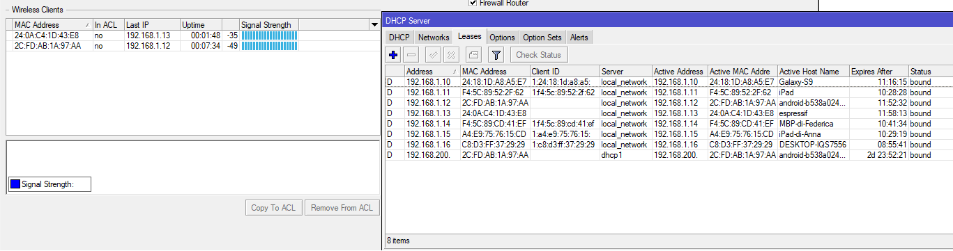

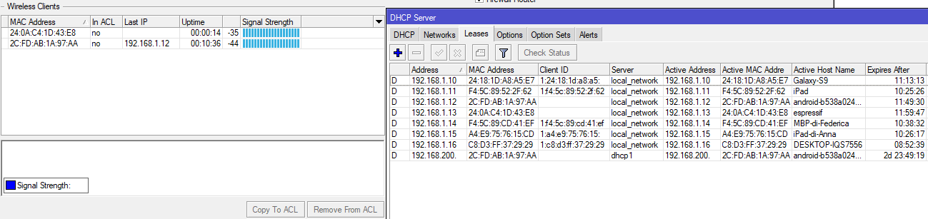

Are you sure that the device had obtained IP address from Mikrotik’s DHCP ? Can you please attach a screenshot of IP/DHCP Server/Leases ?
thanks fo reply szt
I add the info
First device powerup, MicroTik router assign IP but device is always unreachable
After shut off and restar device IP address dosen’t appear
and repeats for all device reconnection attempts
But the log of Wifi connection process from my device side (the STA) at every startup is always this: (IP is always assigned to device)
