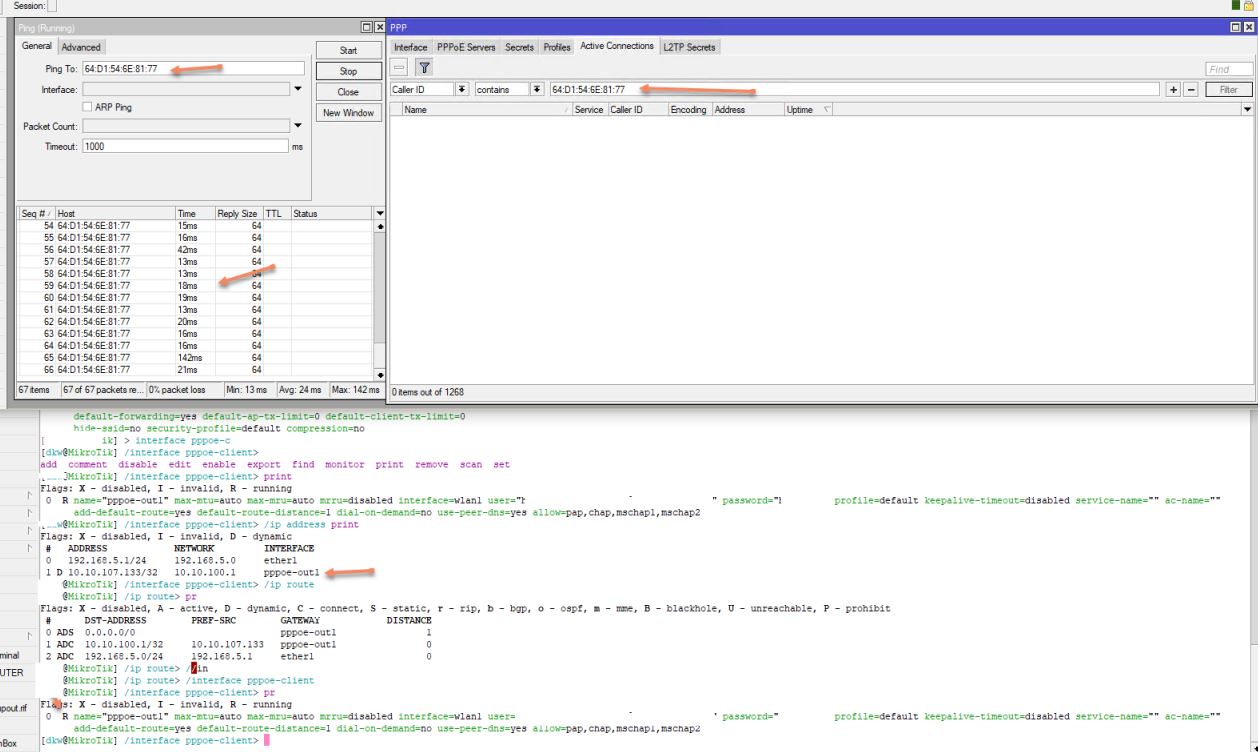

Hi
Anybody else getting stale pppoe connections ?
V6.40.8
CCR1009
± 1200 ppp connections
MPLS/VPLS
It happens on random vpls tunnels and random clients.
pppoe-out needs to be disabled and enabled again to reconnect
Happens with Mikrotik ( all version ) and Ubiquiti antenna’s client side
Once it happens to a certain client it will continue to happen to the same client ( have enabled watchdog on clients antenna now )
Already submitted a ticket to Mikrotik Ticket#2018072322002421

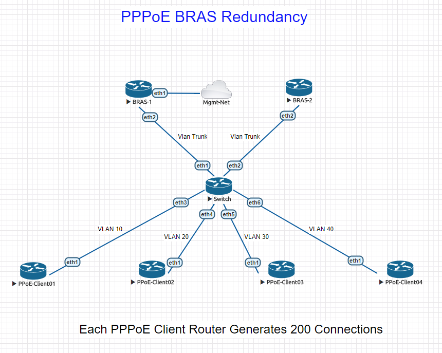

CHR does a pretty good job of terminating PPPoE…you might consider a design like this for HA and scaling.
http://www.stubarea51.net/2018/04/23/pppoe-high-availability-design-incorporating-multiple-access-concentratorsbras/
