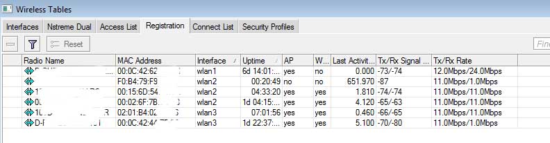

I have been having an issue that seems isolated to the 4.16 APs only where a user connection will stay in the table while its last activity counter runs on and eventually causes the interface to stop forwarding. As soon as the offending connection is removed from the registration table, the interface begins working again. Do not have these issues on any of our older APs and not all of the 4.16 devices are having the problem.
I finally remembered to get a screen shot and post a question. Is there a new setting that I am missing? Anyone else see something similar?
