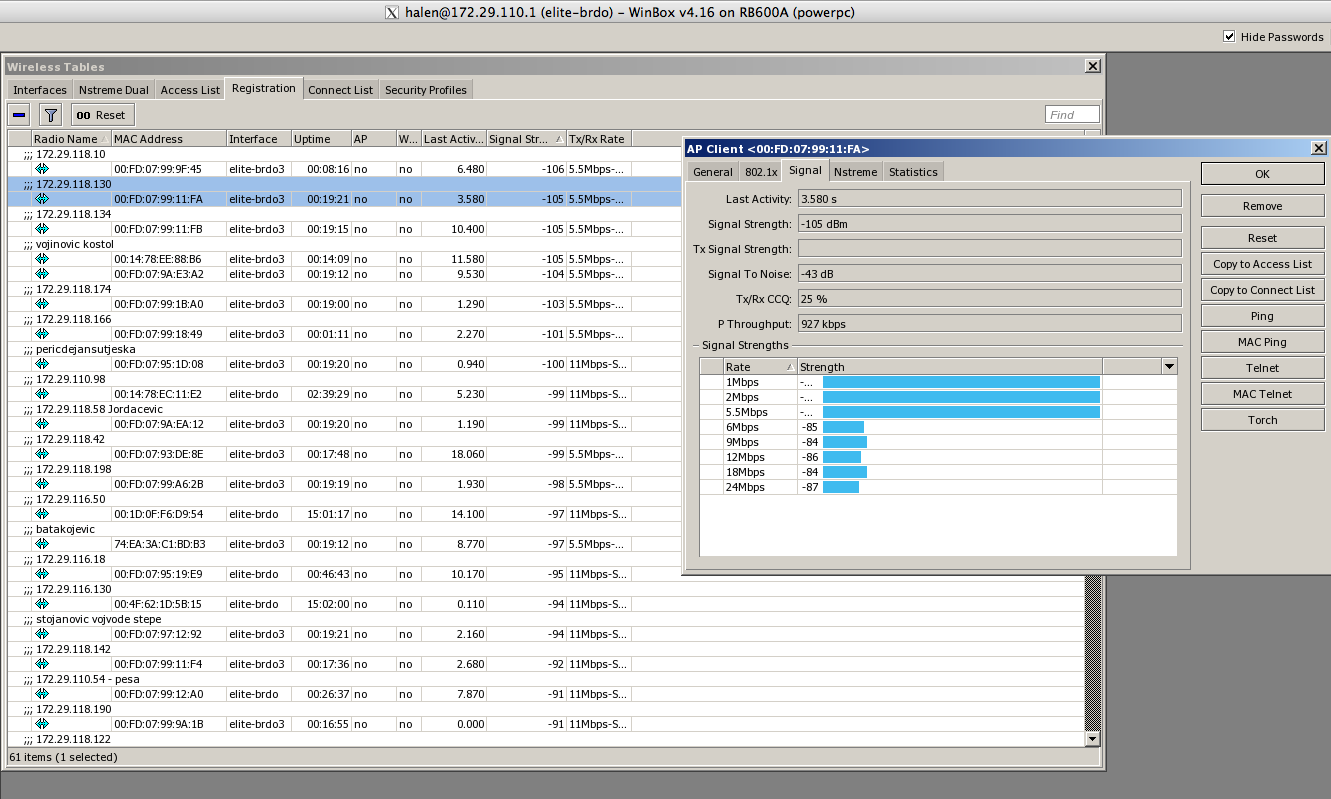

We found that after upgrading to 4.16 signal-strenght have some strange values (from -90 to -106).
SNR is from -30 to -40
INTERFACE RADIO-NAME MAC-ADDRESS AP SIGNAL-STRENGTH TX-RATE UPTIME
0 elite-brdo3 00:E0:4C:FA:63:55 no -76dBm@1Mbps 11Mb... 5h41m52s
elite-brdo3 00:E0:5D:FF:59:6A no -75dBm@1Mbps 5.5M... 5h41m28s
elite-brdo3 00:E0:4C:FB:AC:1B no -64dBm@1Mbps 11Mb... 5h41m28s
elite-brdo3 00:FD:07:93:DE:8E no -103dBm@1Mbps 11Mb... 5h41m15s
elite-brdo3 00:E0:5D:FF:5C:CC no -70dBm@1Mbps 5.5M... 5h41m7s
elite-brdo3 00:FD:07:95:1D:08 no -103dBm@1Mbps 5.5M... 5h41m7s
elite-brdo3 74:EA:3A:B2:7B:03 no -94dBm@1Mbps 11Mb... 5h41m4s
elite-brdo3 00:FD:07:97:12:BE no -88dBm@1Mbps 11Mb... 5h39m42s
elite-brdo3 00:FD:07:95:26:60 no -99dBm@1Mbps 11Mb... 5h38m29s
elite-brdo3 00:FD:07:99:11:FA no -102dBm@1Mbps 5.5M... 4h27m8s
elite-brdo3 00:FD:07:99:0F:D3 no -100dBm@1Mbps 5.5M... 4h10m56s
In AP Client Signal view there is strange look for signal strenght leves per bandwith.
After disable/enable interface everything is back to normal for some while and after few hours problem is back.
Equipment: RB600A + Daughterboard.
Installed cards: XR2, XR5, cm9, 4 wlm-54gp
Some help?

Here is a screen shot…
We checked everything… from antenas to cables and pigtails…
