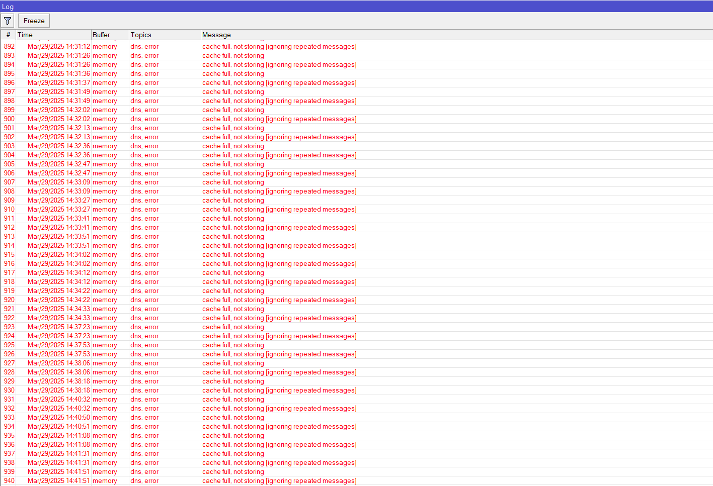

The same thing happened on an RB3011 router that has no static records.
Impossible to tell if that is the same problem.
The DNS cache has a configurable size, default is ridiculously small.
When you haven’t changed it it can easily get full, but that is not the same as the DNS process using up all memory (even above configured cache size)!
But so far, it has not happened that the cache is filled without an adlist or other special settings.
Sorry to be pedantic, but this screenshot doesn’t demonstrate the same issue. All it shows is that your DNS cache is full. While that may be an issue for your setup, on its own it’s not indicative of a bug.

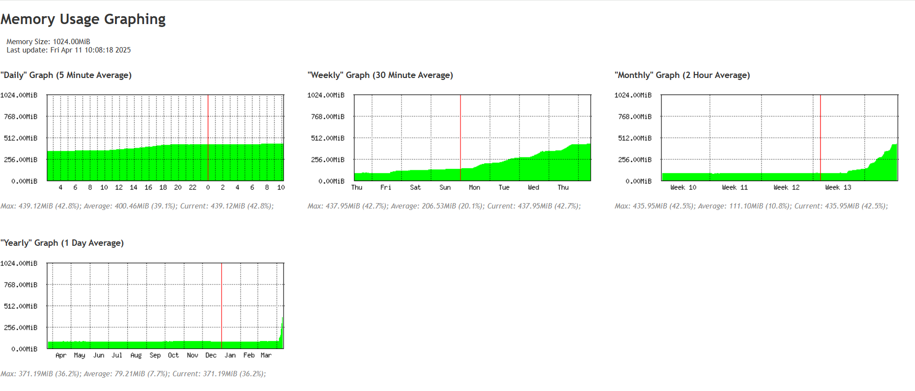

The issue in my post is not simply that the DNS cache is full, it’s that it has a memory leak. This leak causes it to improperly consume more memory that has been allocated to it - eventually exhausting all memory on the router, forcing it to reboot.

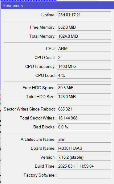

And in my case the amount of memory used increases:

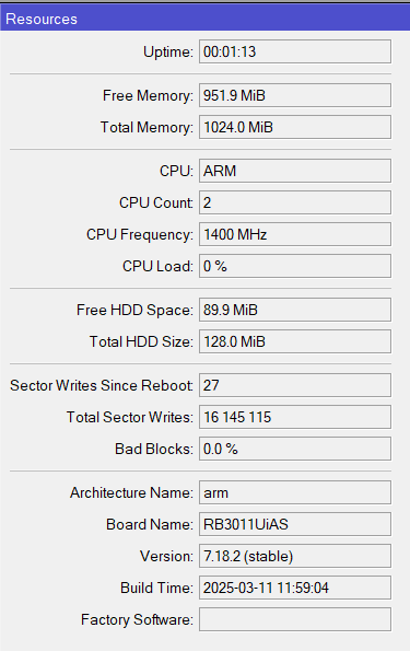

After reboot:
The graphing pattern suggests that there is a memory leak for each query to the resolver.

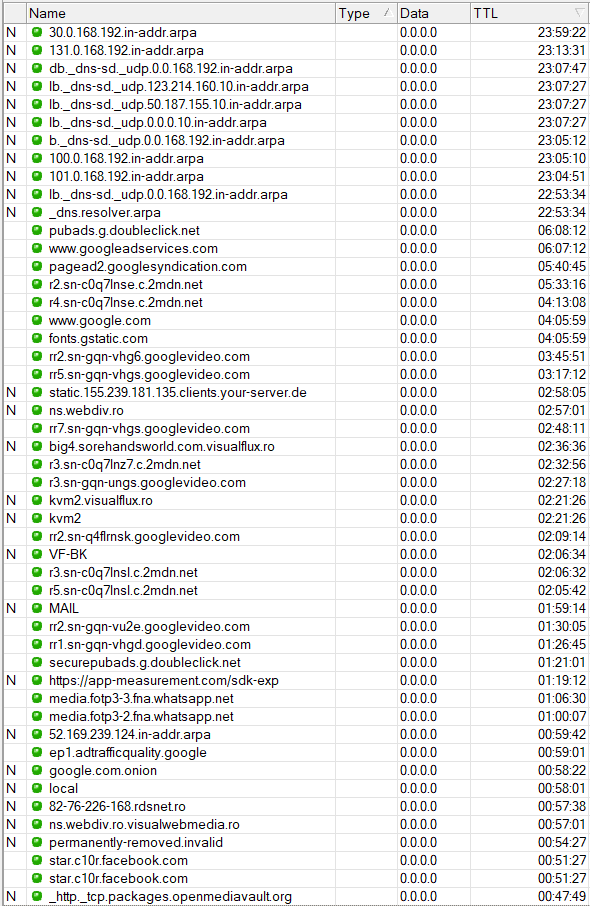

We have seen many interesting problems with CNAME in the DNS resolver before.
Very strange records:
