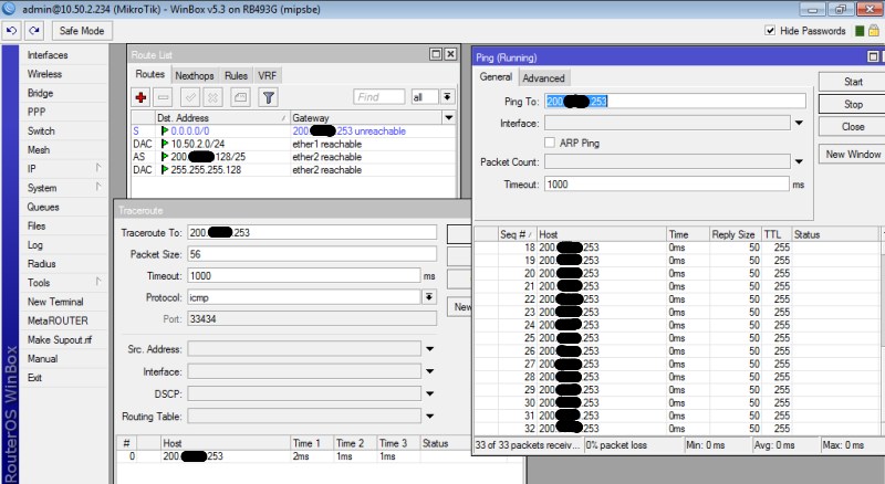

Hi, nobody has the same problem ? is an expected behavior that the RB tell “unreachable” when I can connect to the gateway IP from trace and ping (see image) ? is a very simple configuration, what might be wrong ?
P.D.: note that I arrive to the gateway IP via traceroute in a single hop.
P.D.: this example corresponds to a configuration with a public IP in my office which is similar to the configuration that I put in my client.
Thanks, Bernardo.

Post ‘/ip address’ configuration, it seems like you have entered something wrong, on your screen dump you have a route for 255.255.255.128, that doesn’t seem right!

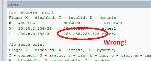

/ip  address  print
 #   ADDRESS            NETWORK         INTERFACE
 0   10.50.2.234/24     10.50.2.0       ether1
 1   200.x.x.198/32     255.255.255.128 ether2
/ip route print
 0   S  0.0.0.0/0          200.x.x.198     200.x.x.253               1
 2 ADC  10.50.2.0/24       10.50.2.234     ether1                    0
 3 A S  200.x.x.128/25                     ether2                    1
 4 ADC  255.255.255.128/32 200.x.x.198     ether2                    0
Thanks, Bernardo.
255.255.255.128 is the network mask, it is NOT what goes under network, here you should put 200.x.x.128.
Hi psamsig, it’s correct, whit a network mask /25 you have only two networks:
192.168.0.0/25 with broadcast in 192.168.0.127
192.168.0.128/25 with broadcast in 192.168.0.255
so when I put network 200.x.x.128/25 it’s correct to see the other host via ether2.
Thanks, Bernardo.

255.255.255.128 is a valid subnet mask, but it is NOT a valid network address for the IP network you’re configuring. Subnet mask does not mean network address. Your configuration is invalid.
200.x.x.198/32 is a point to point address. What you want is 200.x.x.198/25 (CIDR notation for 255.255.255.128. The network address for that subnet is 200.x.x.128 and the broadcast address is 200.x.x.255. Delete the IP, recreate it as 200.x.x.198/25 and don’t touch the network and broadcast address. The router will automatically populate them.
Maybe that’s more clear to you, and you understand what he’s been saying all along.
