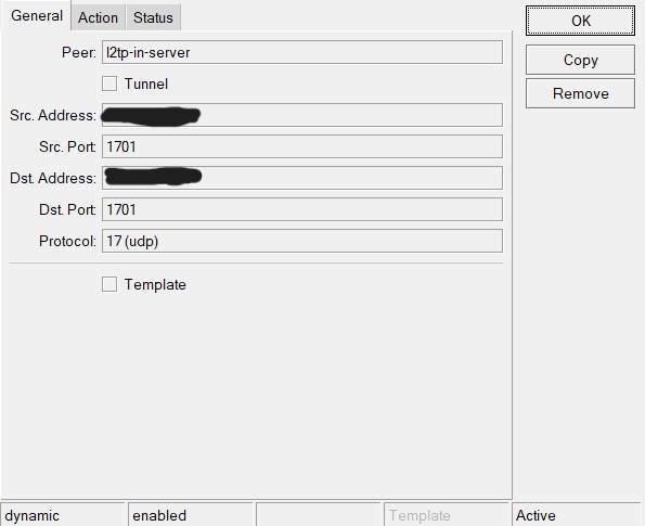

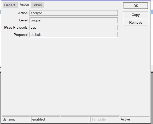

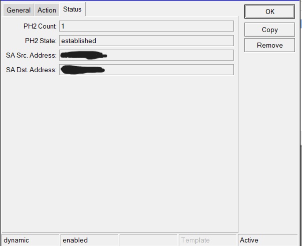

well the connection by miktoik does get established but what is not being forwarded by modem → mikrotik for windows to see it right?
Sorry, I did not understand your description of the situation. You’ve stated that it works end-to-end with the Windows registry change, hence the IPsec settings, L2TP settings, and port-forwarding on the modem must all be correct. The dst-address of the L2TP transport packets is inherited from the IPsec transport packets carrying them during decapsulation, so no dst-nat rule should be necessary for UDP port 1701.
So something in the other settings must be wrong. See my automatic signature for a mini-howto on how to obtain the configuration in a concise form and anonymize it properly before posting.
" so no dst-nat rule should be necessary for UDP port 1701. " without this, but with windows regstry hack i can connect to the vpn. but i want to avoid registry hack .
