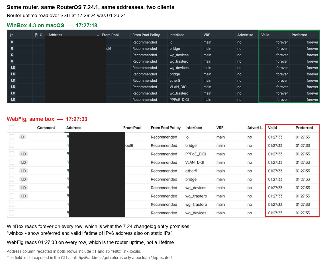

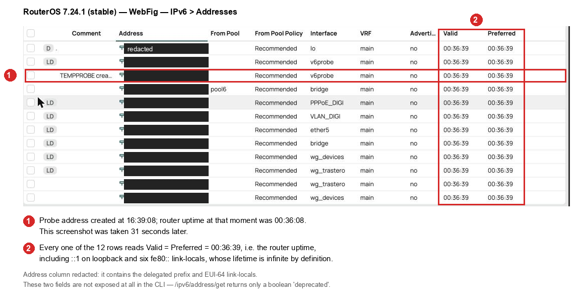

They do exist in WebFig, and there they show the router uptime. Same value in every row, ticking up in real time, the same for a freshly created address as for fe80:: link-locals:
I created that probe address at 16:39:08 with the router at 00:36:08 of uptime, took the screenshot 31 seconds later, and it reads 00:36:39 like everything else on the page. If the column were the age of the entry, the new one would read 00:00:31. It is the uptime.
So @rotor, whatever is stamping 8h onto your addresses, those columns will not show it to you on 7.24.1. Might be worth adding the uptime thing to your ticket as a separate item. It is trivially reproducible and it happens to be the first field anyone would look at when debugging exactly your problem.

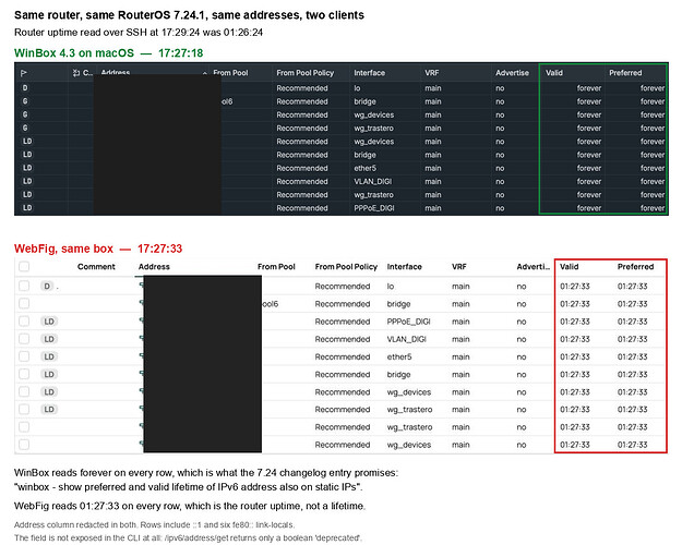

Correction to my own post above, and @CGGXANNX was right after all on this part.
I only had WebFig in front of me earlier. Checked it in WinBox 4.3 on macOS against the same router at the same time, and the two clients disagree completely.
WinBox reads forever on every entry, which is exactly what the 7.24 changelog says it should do:
winbox - show preferred and valid lifetime of IPv6 address also on static IPs;
WebFig on the same box reads the router uptime instead, ticking up in real time, identical on every row including the link-locals.
So the feature works, it is WebFig that renders the wrong field. Which narrows what I said before: the advice to look at those columns is fine, just not in WebFig.
@rotor this is the useful bit for you. Look at your static entries in WinBox rather than WebFig and you should see the actual stamped values there, which is what you need to show the 8h in a ticket. If WinBox does show 8h on entries whose nd prefix default is 30d/7d, that is your evidence in one screenshot.
Reported the WebFig side separately in the 7.24.1 topic.

That /ipv6 address reported bogus address lifetime in WinBox before 7.24 is known (since 7.21 actually). Not only the ones with "forever" lifetime. If you assign an address from a pool that has a lifetime (for example from DHCPv6 client) then you'll see the lifetime value of the addresses decreasing to zero and then start increasing, even when the DHCPv6 lease has been extended. Here's a GIF from 7.22.3:
lifetime-inc
And this is in WinBox. Probably similar to what you now see in WebFig for everything, but I never use WebFig for management. That has also been fixed in 7.24. So, I suggested to OP to upgrade to 7.24 if they want to see correctly reported lifetime for everything (except for WebFig, but didn't know about WebFig because I don't use it).
Of course these fields exist, even in version older than 7.24 here is an output from 7.22:
And here with 7.24.1:
But they obviously only contain timestamp values on non-forever lifetime. If an entry has a lifetime that would be displayed as "forever" in WinBox in 7.24, then the field will contain nothing with the type nil. If you did your test with an IPv6 -> Address table that has a mix of "forever" and real lifetimes, you'll see the fields.
You are right and I was wrong on that one. The properties are called valid and preferred, I went looking for valid-lifetime and preferred-lifetime by analogy with /ipv6 nd prefix, got the same error you get for a property that does not exist, and concluded too fast.
